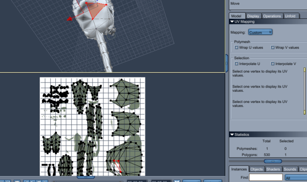

For some reason, the 3D paint brush is working on most of a model, but not in one section. I can't see anything different in the UVMapping between sections in which it is working and sections in which it is not.
Using C8.5 beta in Windows. The model is the armadillo from the object browser. It has been converted to a vertex model. I used uvmap tools in the vertex modeling room. The area that is not working is part of a sub-map. The problem vertexes are part of a named shading domain that was detached in the uv process and projected using the planar (no split) choice, then adjusted a little to spread out the uvs. The paint brush works on part of the area but not on one corner. Can't figure out why.
I've attached two screen shots. One shows the UV mapping zones. The other shows the paint brush room.
I tried moving the entire shading domain to a different part of the uvmap but it didn't help.
688 x 627 - 173K

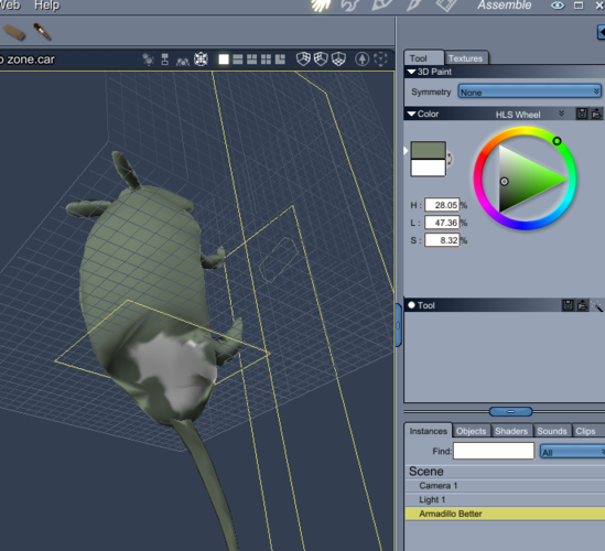

  • DiomedeDiomede Posts: 15,470
    sorry, here is the other screen shot
    848 x 504 - 119K
