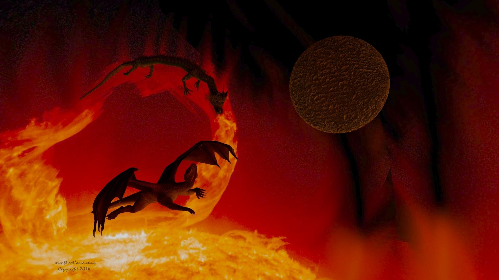

  • FishtalesFishtales Posts: 6,231
    edited April 2018
    I don't see the big differences shown in your examples. I had this render going and I did some using different settings.
    2018-04-27 15:14:50.020 Total Rendering Time: 13 minutes 20.59 seconds
    My default settings.
    Click on image for full size.
    2018-04-27 17:26:17.839 Total Rendering Time: 14 minutes 42.63 seconds
    Firefly lumens 0.
    2018-04-27 18:15:29.858 Total Rendering Time: 13 minutes 52.17 seconds
    Gaussian 0.5

  • AndySAndyS Posts: 1,449
    Hm,
    your lighting situation is completely different to a naturally (physically correct) lighted out- or indoor.
