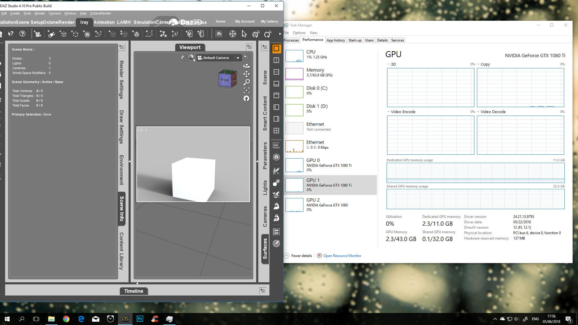

    Here are my 3 Titans, rendering... (ATTACHED IMAGES) Notice the "dedicated GPU memory", per card. Also the "reported activity". All three cards are running full force. But WDDM can't see that, because IRAY is talking directly to the cards. None of the numbers are accurate, or add-up to any realistic reflected reality. The numbers are the same, if I am NOT rendering too. GPU2 is the one that my video-screen is hooked-up to. Thus, it has even MORE memory reserved/unavailable.  (It is a 65" 4K TV.)
    Notice the older titan, GPU1, with the same 12GB, has 1 GB less VRAM reserved. Why??? Who knows... Newer cards seem to have more "reserved", left Unavailable for rendering.
    In TCC mode, as opposed to WDDM mode, the cards showed 11.85GB available, but Daz Crashes, after 1 render, if the cards are setup in TCC mode. (I assume it is fighting with OpenGL, done through windows WDDM drivers, but you tell it to use all three cards for CUDA, in TCC direct access rendering, so it can't "clean-up" the memory. That is what the log-files indicate. They need individual settings for OpenGL and IRAY, but they do not. They are just all lumped-in as one setting, in the rendering area.)
    IRAY works fine in TCC mode, Daz doesn't. (Windows enjoys TCC mode too.) I have asked Daz if they could look-into supporting TCC mode, as it is a requirement for professional development. (I assume they are in no rush, because you can use IRAY-Remote-Render, which works in TCC mode, on another computer. However, I need THIS computer and my remote one, to both work in TCC mode. I don't need just faster rendering, I also need faster DAZ development, of the same size scenes. Which my cards are ALSO used to render. But limited by this WDDM limit. As you see. 5.2GB from 12GB = 6.8GB, which is what ALL my scenes are limited to, at the moment. Less, actually, because the DAZ-program, itself, is part of that WDDM reservation. The scene in DAZ, makes it reserve even more in windows, limiting the "free memory" for rendering. It is a catch-22.

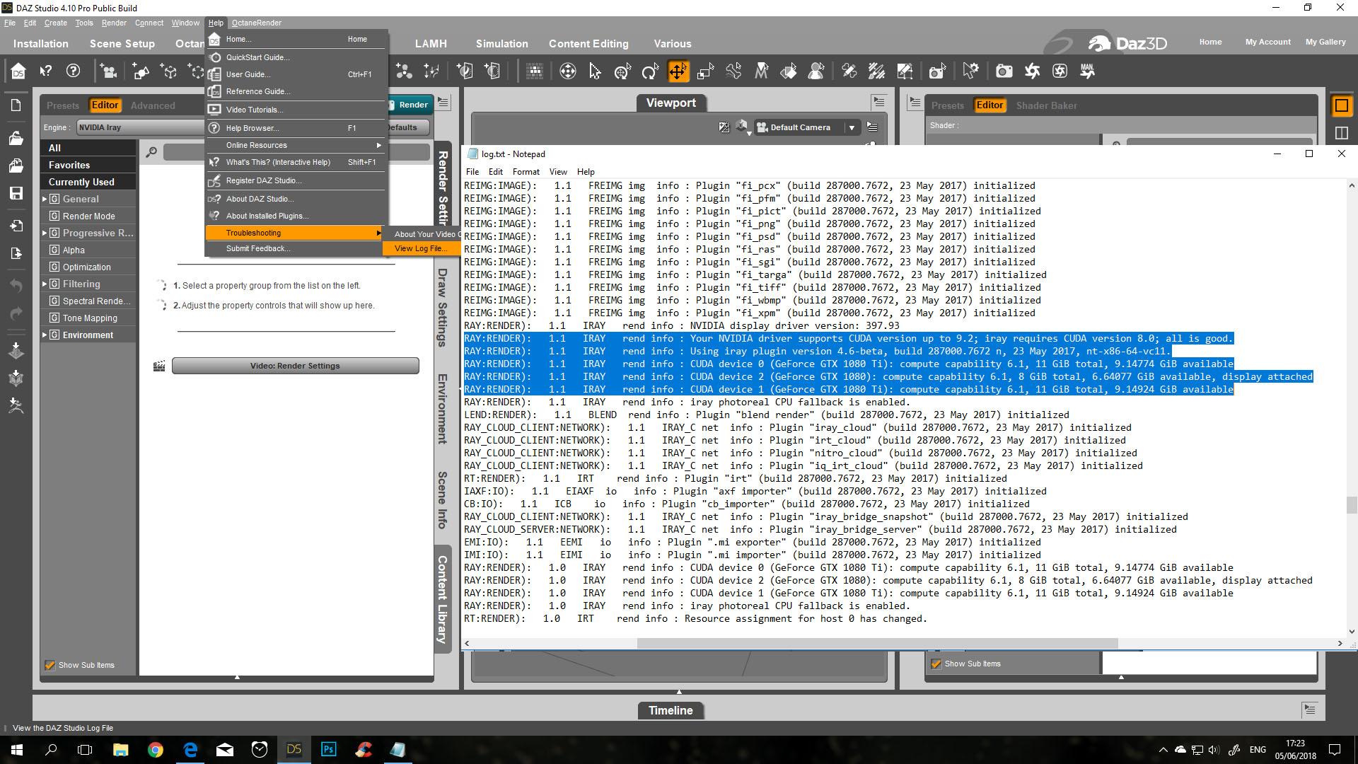

    @ the VRAM numbers that matter for DAZ Studio Iray
    When you are rendering with Nvidia Iray all that really matters are the "available VRAM" numbers that are indicated in the DAZ Studio log screens.
    https://www.daz3d.com/forums/discussion/172866/quick-guide-finding-information-about-vram-directly-in-daz-studio
    ​Just have a look at those numbers during render time on your own system.
    2017-06-01 07:11:49.303 Iray INFO - module:category(IRAY:RENDER):   1.0   IRAY   rend info : CUDA device 0 (GeForce GTX 1080 Ti): compute capability 6.1, 11 GiB total, 9.17244 GiB available"​
    ​Is there any DAZ Studio and windows 10 user out there who can post a screenshot of this line where it reads
    11 GiB total, 11 GiB available"​
    yes? no?

    My impression is that it is a small number of people on the DAZ Studio forum who keep repeating that this issue is a myth.
    So far I have not seen a single screenshot of the Iray DAZ Studio log file from people claiming that this issue does not exist that proves that on their system Iray can use all the 11 GiB of VRAM of a GTX 1080 Ti set up as separate rendering GPU.
    If you can provide a screenshot of the DAZ Studio log file of your working system then please do so.

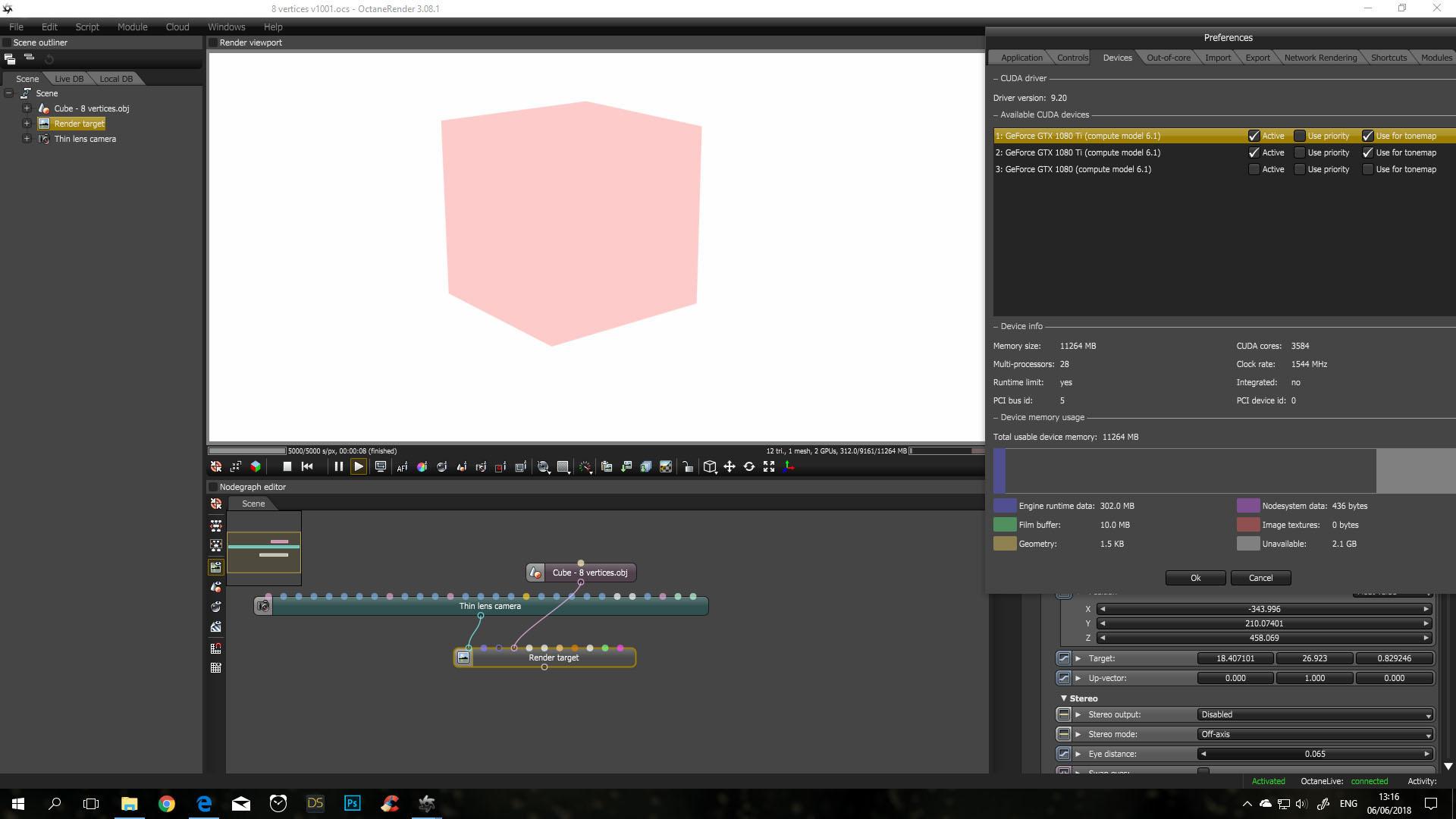

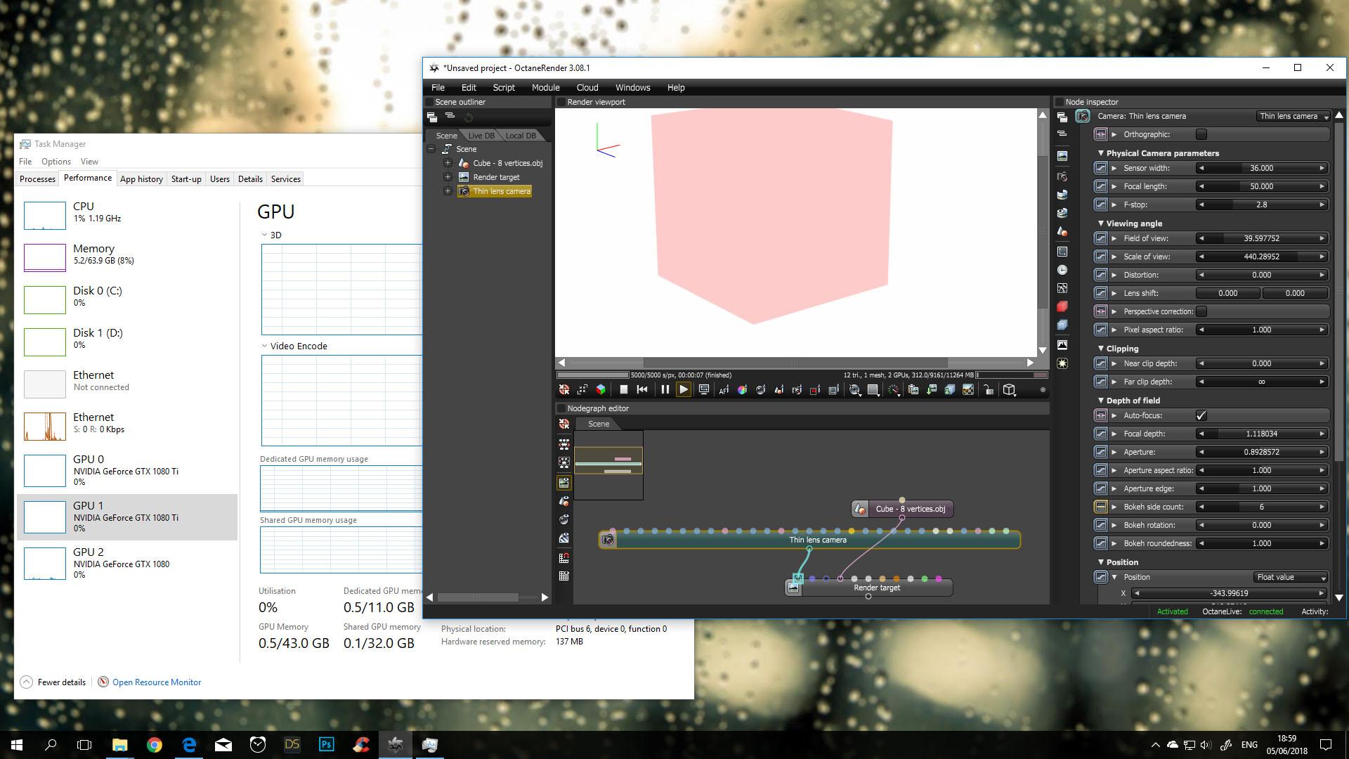

    OctaneRender developers stated that all Cuda related applications are affected.
    OctaneRender and Iray both rely on Cuda.
    https://developer.nvidia.com/cuda-zone
    The facts that matter to DAZ Studio Iray users are the numbers the DAZ Studio Log files give us.
    The facts that matter for Octane Render users are the numbers indicated by the internal render engine tools.

    What we can observe is that since the Windows 10 2017 fall update the windows task manager has been updated to provide more information about multiple GPU.
    https://blogs.msdn.microsoft.com/directx/2017/07/21/gpus-in-the-task-manager/
    My personal impression after reading through that blog entry is that "available VRAM" is part of a complex system.

    But it really should be enough that you open up the DAZ Studio log file and check this line:
    That the available VRAM on a dedicated rendering GPU is not equal the total VRAM is all the "proof" you need to positively confirm that there is an issue.

    FWIW, there is a nice explanation of the new Windows 10 Task/Performance Manager, which now shows detailed GPU information, written by the Microsoft lead engineer responsible for the GPU scheduler and memory manager. And it says the following about "Dedicated VRAM":
    "Dedicated memory represents memory that is exclusively reserved for use by the GPU and is managed by VidMm. On discrete GPUs this is your VRAM, the memory that sits on your graphics card."
    On my machine, with an 11GB GTX-1080ti, after I load a scene it says "6.6/11.0GB" of Dedicated Memory. Which, according to him, means that there is the full 11.0 GB of dedicated memory available, and the particular scene is taking only 6.6 GB of that. BTW, that number matches what's shown in GPU-Z for Dedicated Memory Usage.
    So unless I'm mistaken he seems to be saying that the entire VRAM is exclusively dedicated for use by the GPU. Unless VidMm does something goofy that he's failing to mention. Though I'd think they'd be VERY aware of how they programmed VidMm, especially on something important like this. And if they were aware that only, say, 8GB is left after W10 grabs it's own chunk, it would say "6.6/8.0 GB" wouldn't it?
    Anyway, here's the link to the blog post. Even if you don't believe my interpretation, the writeup is surprisingly well written if you want to understand the new Task/Performance Manager and what it all means.
    Post edited by ebergerly on

  • ebergerlyebergerly Posts: 3,255
    I did a little more investigating, and merged a few scenes into DAZ Studio to see if I could get my VRAM Dedicated Memory usage up close to the limits of the VRAM in my 1070 and 1080ti. And the results are shown in the images below. The merged scenes used a whopping 35GB of my system RAM, but both GPU's were rendering full bore, no crashing to CPU. And my 8GB 1070 was using almost 7GB, and my 11GB 1080ti was using almost 10GB.
    I'm just not seeing the issue. Supposedly W10 would take something like 2GB of the 1080ti VRAM? I suppose I could merge some more scenes to see if I can get over 10GB of VRAM usage in the 1080ti just to prove the point.
    edited June 2018
    The images I posted were from the Windows 10 task/performance manager, which has been updated recently to show GPU info. And you would think that those would be the most reliable numbers, since the Windows 10 VidMm is the scheduler for all of this.
    And it also seems to say that each GPU will be loaded up to near its capacity, and the lower VRAM unit won't limit the VRAM usage of the higher VRAM unit. I thought that was a big concern by some folks, that if you put a 1080ti with a 1070 for example, the VRAM usage of each GPU will be limited to the 8GB limit of the 1070. Or am I mis-remembering?
