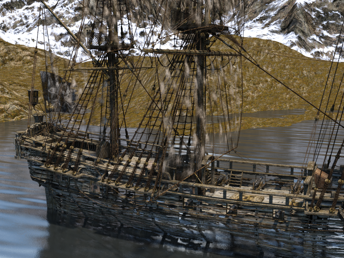

    Taken from the instructions above.
    The main part of the Medusa is found under characters/figures, I loaded the main figure from the Medusa (not P6) folder. There doesn't appear to be a preset loading it with the Ghost Ship textures already.
    Went to the Raw-GhostShip folder under poses, then applied the PP mats.
    Went to props, where there are props with the ghost ship materials already applied in the Raw-GhostShip-PP folder. Loaded the props and all the open versions of the sails.
    The sails parent in place, the rest of the stuff on the deck did not, but you can parent all of those under the main body of the ship it looks like, you don't have to go hunting for specific bones on the ship to parent it to, so you can select all the props and drag and drop them at once when loaded.
    Selected all that and all surfaces and applied the iray uber default material that comes with Studio.
    (click for larger)
    Out of the box with just the base material applied I think it turned out well. If I were doing more close ups, I would spend a little more time on the surfaces (you can see the cannons in particular here look a bit shiny or like plastic), but if you have any iray shader presets for basic construction materials it should be pretty easy to take this up a notch.
    Just wanted to give you an idea of what it looks like. Didn't take long at all either, pretty easy once you know what folders to look for.
