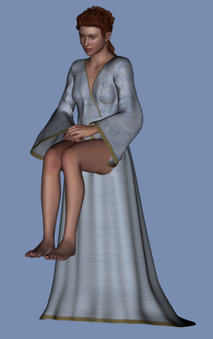

I loaded the Lion Queen dress onto Genesis female and Genesis posed while the dress remained upright. I tried to manipulate it to "bend" but it didn't work. Does anyone know what the procedure is? It can be done because there's the picture.
Much appreciated.

    Look in the Parameters tab for a "Sit" morph.
    Long skirts can't be made to conform automatically to the movements of two legs at once. The usual solution, and it does have limits, is to add movement morphs to the dress for things like walking, sitting, etc. Note that this isn't a quick "one dial spin and that's it" fix, you will probably have to fiddle with the dress morphs to get something that works without too much distortion of the dress model.
  • NovicaNovica Posts: 23,925
    Steffany- remember too- get the dress somewhat in position, then go to the SCENE tab and open the submenus then shut the eye to hide the item in the scene. It speeds up render times too. So you'd go Genesis then click on the arrowheads and open up till you get to the thighs and shins, then click the eyes next to them and those items "disappear." Does NOT remove them from the scene. That way you can bend the legs and work with it so there's no poke through.
    Most importantly, get her posed and ON whatever she will be on- and decide your camera angle.You may not need to fuss with the full length, so why fix it? (speaking from experience, I messed with a dress and didn't even NEED to. I was so annoyed with myself!)
