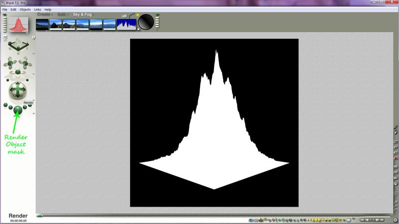

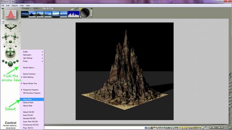

OK I thought I would dig out and dust off Bryce 7.1pro and give it another shot my question is can I get rid of the sky background so I can make things on a transparent background?
    do a mask render , use the mask render to cut out the background

    Thank you Chohole I am new to this is there a tutorial. ok I got it thank you Chohole I know what I am doing now I had it on no mask now its on object mask.
