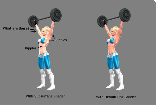

I've been slowly introducing Subsurface Shader into my scenes with pleasing results. However, I've recently encountered something odd. When rendering a figure with "sweaty" skin, I get what appear to be ripples in the specular highlights. These do not appear when rendering up close, but when pulling back, they start to appear. Note the difference between the images on the right and left. The image on the right's specular highlights are smooth.

The above are all currently set to zero percent because when I first encountered the issue, they were the first dials I changed to try and fix. Does anyone have a clue what might cause this? My scene has 12 lights. 6 are shadow casting. Issue occurs with both raytrace and deep shadow map. Any ideas?

In scenes with more ambitious lighting (several shadow casting lights and several ambient lights) I will occasionally get "glitches" in the render. You can see this on the right arm of the figure on the left. It happens randomly with or without Subsurface shader. Any idea what might be causing these?

  • jestmartjestmart Posts: 4,449
    Make sure the Shading Rates setting and Shading Scales settings are the same for surfaces with the same Group ID #.
    Thanks. This resolves issue #1. I'm still working on eliminating Issue #2.

  • MattymanxMattymanx Posts: 7,002
    Those glitches are caused by Shadow maps. Switch to raytraced shadows. It will render faster with raytraced shadows anyways.
  • Joe827Joe827 Posts: 274
    As I mentioned above, I get these with both shadow maps and raytraced shadows, but only when the lighting is complex. Also, your comment about raytraced shadows being faster puzzles me. Raytracing shadows has always been slower than shadow maps for me.
