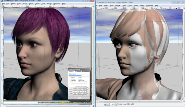

Dear all,
I have first posted my problem at Daz Studio discussion forum but after no responses I have decided to repost here since the problem is more related to Bryce than DS itself. Well, I hope someone will be able to advice me on why Genesis textures are not showing up correctly in Bryce this time as previously it worked! Actually I did not have the problem when exporting from DS4.5 as you will see in the render with text on. Funny thing, Genesis textures do export correctly when I open the character by itself in Bryce as per image shown below. But the problem occurs when I copy and pasted it to the full scene (same method which I have used before). The other characters on the full scene was done from exporting from DS4.5 - Genesis lady pushing pram, Genesis male driving the 1951 Cruiser Trike and the Kids 4 boy in front. You will notice that all the textures worked perfectly then!!
But recently I have installed DS4.6 and wanted to finish the render to add a driver to the Dixie car. Previously I had added 2D PaintShopPro tubes on it as I was awaiting Wilmap's Roaring 20s clothing to use in the scene. After done everything yesterday as previously, rendering Genesis female body parts is white-grey, as well as the hair. It is the very same hair I have used on the lady pushing the pram !!
I just want to add here that I had took off all the characters and parts of the trike as Bryce crashes with too much objects in the scene. Then I am planning to cut-out the final part with Dixie car and pasted back to scene with rest of characters.
I have attached the images exporting from DazStudio through to Bryce7. Maybe someone can give me advice!?

  • srieschsriesch Posts: 4,243
    @launok, I'm not sure I'm quite clear on what you are doing when the textures go away. Can you clarify? Are they lost during the transfer across the bridge from DAZ Studio to Bryce, or during a Bryce File > "Import Object" of the figure exported in DAZ Studio, or something else?
    Or were you saying that if you transfer just the figure across the bridge it works but if you transfer your entire DAZ Scene across the bridge you loose the materials? If so, try sending just one figure at a time instead of all at once. If it starts failing after sending a few figures, try again with a save/exit/reload between each use of the bridge.
    I tried sending a random figure, clothing, and hair across the Bridge from DS to Bryce. The eyelashes are screwed up (and I think there might be a workaround posted somewhere to fix that, I'll have to go digging), but other than that it seemed to work.
    Do you know which hair that is, in case I have it already to test with?

  • launoklaunok Posts: 807
    Hi Sean,
    I am quite a newbie with these things. If you look at my 2nd image Genesis turned out beautifully in Bryce, textures and all, almost the same as the original in Daz Studio (1st image). This, in my opinion, shows that the bridge worked as should be. Also in the 1st image I have included the DS settings (left side on image) of how I have done it before exporting as an .obj. I have never changed these settings as I don't know much about these. I have simply used the settings as is, there is an automatic checked part for Bryce too, so I simply didn't bother to play with these. So not sure if this is correct or not. All I have exported was only Genesis with clothing/hat/hair already parented in DS. I am not sure if I have handled this correctly in Daz Studio, but I have actually clicked on the full figure, clicked on export as .obj in far as I can remember which brought up the menu and saved it to my documents folder. From there I have opened Bryce and imported the saved .obj from my documents, as seen in 2nd image which looks fine!
    Bryce is actually quite tricky in the sense that you can't work with 2 scenes opened at the same time unless I am doing it wrongly !??? I copied the "red" wire-frame object (Genesis), then opened the scene where it must be transferred. But always when I open a 2nd scene, the 1st scene kind of closes as it always asked if I want to save my scene before closing (is this how it works when using 2 scenes?). Then the 2nd scene appears after a while and only when its fully loaded, I past the object.
    I have to admit that I have taught myself everything and if this is the wrong way of copying/pasting, please tell me!!
    The fact that Genesis did opened up fully textured 1st time in Bryce tells me that the problem may be in between the way I have transferred it between the 2 scenes. I also have asked this previously at DS forums but when no-one responded to the DS/Bryce problem I came over here instead as it is more Bryce related, I think.
    But the only way I can go with this is by trial and error and with some help. There was simple issues I had when first started with Bryce and the forums helped me quite a lot which I am very grateful for! :) SMILE
    Laura
