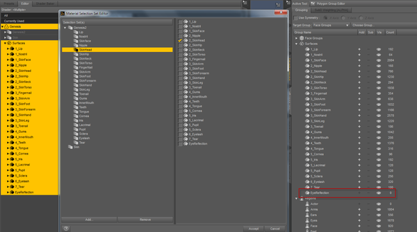

    You can create surface selection sets with the same surface name on genesis without the number so that the preset will also be compatible.
    A little trick for the eye reflection would be to use the polygon group editor to add a surface named eye reflection without anything in it for Genesis
    I didn't do it myself but that should work
    [EDIT] Did it on my Genesis and it works. I can load G2 Bree Preset on Genesis. I don't have the corret UV Set (Base Female) but all the surface settings are there. Saved Genesis as Figure/Prop Asset to keep the modifications
