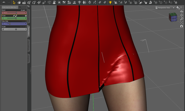

this is now my first Hexagon Model, a Dress for Genesis, but i don't know howto get the Dress following Poses of Genesis. If i move the leg of Genesis, the Dress looks like the Picture at the end shows. Also Shapes for Genesis let the Mesh of the Dress explode.
What to do next, to get a Dress that follows the Poses right and can be used by other Shapes?

    Yes, you need to use the Polygon Group Selection and Weight-map Paint tools to edit the maps - skirts are quite tricky as you want a smooth blend from right to left, but the Transfer utility has probably given you a much sharper split (hence the crease). Try selecting the skirt with the Polygon Group Editor and then with the Weight map painting tool select the map for that bend in the Tool Settings pane then right-click in the viewport and select Smooth Selected faces.
    If the mesh is low resolution it will probably have trouble following the morphs, but exploding sounds very dramatic - perhaps an image would help.

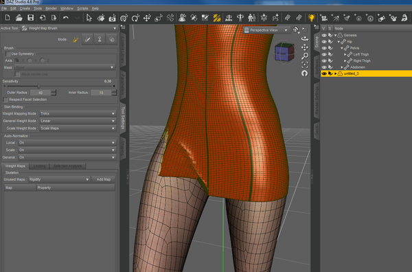

    there is no Map to select, how to create a Weightmap to select?
    My Tool Settings looks like this:
    1290 x 851 - 580K
  • WilmapWilmap Posts: 2,917
    You ned to select the Left and right thigh and adjust the weight map for each seperately. Click on the little arrow next to your dress name and you will see the bone names.

    Wouldn't it be simpler to add a smoothing modifier? Changing weight maps is fairly complex for a new user.
    If just changing smoothing intervals doesn't help you can also reduce the weight to .4. You will need 'show hidden dials' ticked to see the weight slider.
