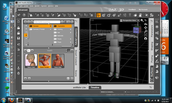

I am at my wit's end! I had Daz 4.5 and the genesis essentials installed. Everything was working fine. Yesterday I decided to upgrade to 4.6 and install genesis2 essentials. I used the install manager to do this. When I tried to use the genesis2 character, I got a 'boxy' figure. Ok I uninstalled everything. Did a restart and system restore to several days ago. That did not help. This morning I uninstalled the 4.5 and just for good measure, I put all my studio files in a separate file in my docs. Fresh start and all that. I then downloaded the 4.6 and installed manually. Downloaded and installed the genesis essentials and genesis2 essentials manually. I'm till getting these 'boxy' figures. Sorry, I don't have screen shots at the moment.
Can someone please help me? I'm really frustrated and ready to quit playing in DAZ.

I decided to try and install my old Aiko 3. Still getting the boxy figures. However, when I rendered her (just for fun) I get Aiko. This is really wierd. I now have a trouble ticket at the help desk. Any thoughts are still very much apprecitaed. Thanks in advance.

    Do they appear in 'box' mode on loading in the viewport, or is it just when you move them?
    If it only happens when you move the figure, go to Window > Tabs > Tool Settings, and look for Draw Style, and set it to Use Current (Off).
    If none of that is the case, then you may have the install in the wrong place, or your Content Directory Manager doesn't have a list of the correct folders. Can you post a screenshot of your Content Directory Manager showing the expanded listing for both your Poser Formats and DAZ Studio Formats?

    Are all your figures loading as Blocks or just G2F? Things to check, be sure that the content folders are mapped in prefs properly. Then be sure your display mode is not set to Bounding box.

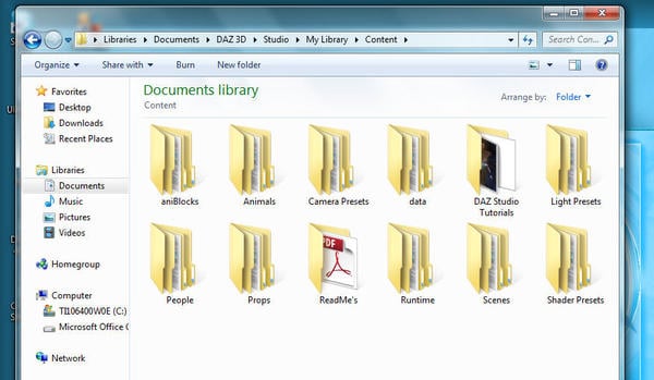

    Here's the screen shots

    DAZ Studio cannot find the data folder where you installed Genesis 2 into.
    Where did you install it to exactly, and did you do it by hand or using the DIM. The DIM uses a different folder by default, called My DAZ 3D Labrary.
    Please post a screenshot of how your directories are listed in the Content Directory Manager, that is the problem I think.

    You should NOT have a Content folder inside the My Library folder, that will cause you problems.
    You MUST take everything out of the Content folder, and move it all up one level so that it is directly in the My Library folder, and delete the empty Content folder. After that it should work.

    Yes, that is the Only Error I see.

    I have just looked at your first images again, and I have been off on the wrong track.
    What you are missing are the files for Genesis, and NOT Genesis 2, did you install the Genesis Starter Essentials into that folder as well? Can you load the base Genesis model from the Genesis tab, not Characters as seen in your first images? Just click on the orange Genesis tab, and there should be a file there called Genesis.DUF. If that is not there, then Genesis Starter Essentials has not been installed into the folder you are working from.

    OKAY Quick Help I hope. The FOLDER in the Zip Files named CONTENT is not needed. You open that Folder (after unzipping to a temp folder) and move the Content inside the folder to your YOUR content folder, whatever the Name is. Only the DIM uses that top folder, which is tossed away, the CONTENT inside the folder is all that get's installed. If your Path for Content is Blah/My Library then you Copy Paste or Move the INSIDE contents of the Content folder to My Library.
    Wrong:
    Blah/My Library/content/data
    Right:
    Blah/My Library/data
    So this:
    content/data and others... Becomes
    This:
    My Library/data and others...
    You only want the insides of the content folder in your TOP folder.

  • ben98120000ben98120000 Posts: 469
    Do you still get missing files error?
    Im looking at the picture you posted in first post. That little cube next to Perspective View, click on that down pointing triangle and change option to texture shaded.
