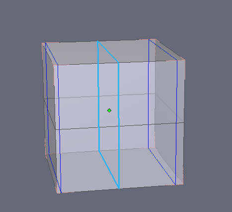

    Yup. It is persnickety about those matters.
    On the cube I tend to make one looped tessellation twice, once for either direction.
    Then select each set alone and slide them to centre positions, and do an extract both sides.
    That usually works okay.

    are you validating and collapsing the geometry other than that im stumped

    Yes and no. Haven't tried in a while but my first cut would crash it. So no time to validate anything. But I understand you need to validate between steps. At the time I was following a tutorial I found and was doing the same steps but without success.
    Sometimes the first cut wouldn't crash but instead destroy the cube and add a ton of faces for no reason. Then it would crash.
    Thanks for the tip. I've got a lot of modeling experience, just not in Hexagon and when I try to give it a chance it spits at me and makes me sad.
