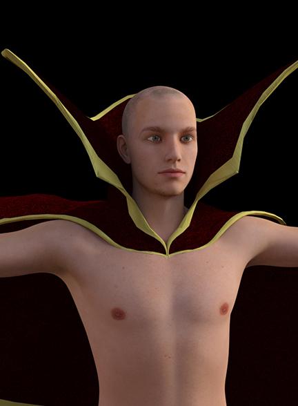

  • RKane_1RKane_1 Posts: 3,037
    edited April 2018
    Thanks to both Redz and Sickleyield for their helpful assistance! :)
    Still working on it. :)
    432 x 588 - 156K
    Post edited by RKane_1 on
    I know.... what a strange cloak. :) Right?
