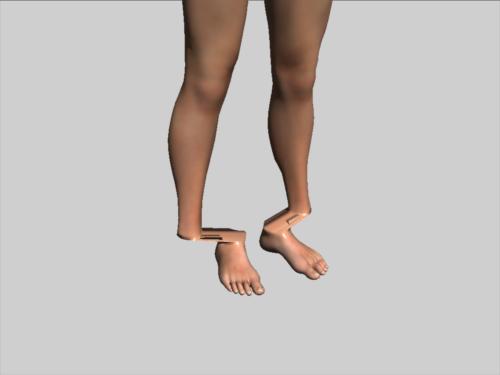

I am trying to use Fenric's weight map conversion utility to get the Poser Pro default figures (Rex and Roxy) converted for use in Carrara. (Poser Pro 2014 into C8.5 Beta, windows 7 operating system). The instructions are in general very good. However, I could use just a little more help in understanding how to handle the problem of the feet being parented to the body. The instructions say to edit the CR2 file. But what specifically do I need to do? What lines need to be edited to correct such a parenting, and how?
one old forum post I found through the search is below but it didn't clear it up.
http://forumarchive.daz3d.com/viewtopic.php?t=186247&postdays=0&postorder=asc&start=60
500 x 375 - 9K
  • FenricFenric Posts: 351
    Just like Tyler and Miki4, Rex and Roxie have a very odd thing in their CR2 files: in the "Figure" section, the rFoot and lFoot are children of the BODY node instead of the rShin and lShin. You'll have to fix that manually, it is not something my utility can deal with.
