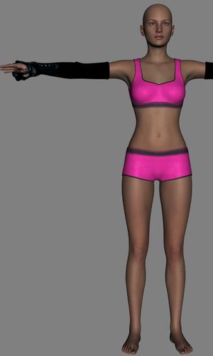

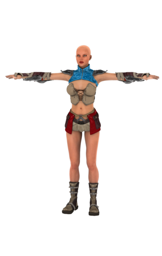

    Ok so this is a quick render with a V4 oufit on V6 using V4 shape and the auto fit. The boots fit superbly but on the arms everything is off. I'm gonna say the auto fit for V6 is hit and miss because on some other outfits ive tried over the last 2 days i've had mixed results. Sometimes the boots wont line up and some sometime its both arms and feet apparel but the main body outfits always fit.
    1080 x 1700 - 419K
    I haven't used V6 much but that does look odd. Let me try with something that is similar. I don't have that particular item...I least I think I don't. Too much stuff and I still haven't installed the non daz stuff since the arrival of DIM.

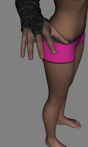

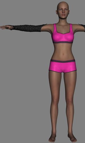

    Okay...I had a play but I'm not seeing the same results you are getting. Everything I have tried has worked so far. Here are some images
    I did learn something new that I hadn't realised before about using smoothing though. There was minor pokethru on the coat so I tried adding weight by making it .70 and it made it worse so I reduced it to about .4 and that improved it without changing the smoothing iterations. So there is something useful to know.
    Can you please outline your process? Which template are you using?
    Are you sure that is V4? It looks very similar to a lot of outfits I have for V3....3D has fashions changes just like the real world. ; )
