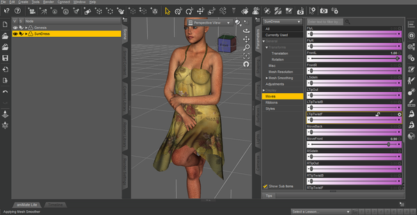

    Select the dress, go to the Parameters pane, and use the FrontL morph to move the left side of the dress towards the front. You may need to use some of the other morphs too. See my screenshot below...I used the same (or similar) character, and a similar but more extreme pose. Obviously there are other issues due to the pose (her hand, for instance)...I just concentrated on fixing the thigh issue.

    Thanks - that worked, but I'm confused. I had tried that before, but with collision iterations set high, and that seemed to mess it up - the morph simply caused the dress to raise up at the front a la Marilyn Monroe. Without collision iterations, I also managed to sort out the hip orientation problem, simply by adjusting the Rside in morph (though I had to extend the parameters). With the collision iterations on, that didn't work before. either. Final result shown in image.
