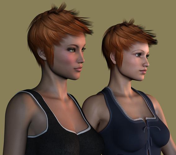

    Proudly presenting Chiara (V6) and Cassini (V5) Rockin' The Pure Hair: Space For Genesis!
    (Note: Chiara and Cassini are MY two characters- not in store. I know that can be confusing if you're not following my art studio thread.)
    Over 13 hours (setting was the .010) and won't be doing THAT again with two figures with the same hair!
    This was to show the PH Space could work with the Genesis V6 figure. (My Chiara) It also said it was for the guys so here' the gals wearing it.
    And thanks again for the help.
    The hair reviews start here:
    http://www.daz3d.com/forums/discussion/19756/P510/#360919
    but they will not be with that .010 setting unless they render a lot quicker!

    Worth framing :-) Congrats.
  • NovicaNovica Posts: 23,925
    LOL- well....not ready for a museum wall, but the one in my foyer perhaps... (I can just see my family saying, "Who the heck are THEY?" To which I would reply, "My 13-hour-keep-checking-on-them pals." I wish I could have tweaked the lights, but at least the hair really shows well. The Pure Hair series is doing nicely for Genesis 2 (I just reviewed another one, only took 3 and a half hours with the shading rate .085, and am doing another one right now.)
    So thanks! *Smile* (since smiley faces seem to be a thing of the past for WEEKS)

    Yeah, spot renders can only warn of so much. Some have also mastered carefully done post work to make some of those "other" corrections. Word may vary from program to program, the brush/option is called "burn" in some. Can lighten/darken areas for touchup ... but for those reading this who are new to the entire concept; "always" work on a copy ... and using layers is a good idea too.

    Yep, I did a post in my art studio about the value of post work. We have PhotoShop with layers, but I haven't had time to tackle that program yet. I do lighten/brighten in Corel Photo Paint and adjust brightness, contrast, intensity- but this one I thought was good enough to showcase the hair. In Corel, I think it was "dodge" but it's been awhile. It was a Q-tip looking thing. And my Corel is funky- sometimes it won't show the brush and no matter what tool setting I go into, I can't make the brush reappear unless I close out and come back in. Love/hate technology!

    Dodge! Yes that's the other word used. I find PSP tends to loose a window tray when it's minimized; but if one brings the cursor to the far left side as to drag wider or narrower the tray, it'll reappear.
