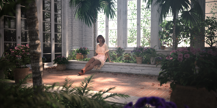

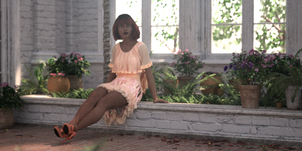

    dForce defintiely works. Here's two quick dForce renders I did with default dForce settings. I also have 6GB Vram and 32 GB system Ram. Stonemason's Private Garden. No issues. Stopped the second render to fix the poke through.The system can handle the load. I even did the dForce sim after the whole scene was loaded.

    I'm aware it works, when it works, but the issue is that it seems to be rather hit and miss. Sometimes it'll work just fine, and other times it just 'explodes' clothing items for seemingly no reason. I've had outfits clipping through the character (not just in a minor way, but rather having large chunks of the mesh push through), and so many memory issues that I'm starting to wonder if my PC has Alzheimers. At least it seems the clipping issue is universal; I notice the wall can be seen through the dress.
