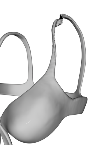

    Got this Issue Today ..
    Is this something about WeightMapping ? or do I have to a JCM Fix here .. ( It´s lCollarUp) ?
    1191 x 1701 - 752K
  • KatteyKattey Posts: 2,899
    bloodboy, with which figure this issue and what are those clothes?
  • bloodboybloodboy Posts: 68
    It Is my own clothing piece for V5 .. And if change the TriaxWeightMap to Generalweight it Works .. My question just was if i do a New WeightMapp or a JCM instead ... which One IS better JCM or WeightMap ?

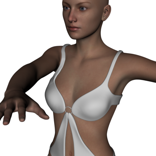

    Allright reworked .. a bit and now I understand .. a little bit more about weightmapping as well ..
    Should I do the Gradient with Spherical Gradient or by Paint what do you prefer ?
    Also with WeightMapps should I add JCM on some Joints anyway ??
    How many Polygons should a Clothing Piece have ?
    800 x 800 - 411K
    I prefer to adjust mine with painting after I use Transfer Utility.
    Sometimes JCM are still useful on a weight-mapped item. Look at the individual bends and see if you're happy with them.
    There is no set answer for poly count. I try to keep it under 20k for a shirt/swimsuit like this one.

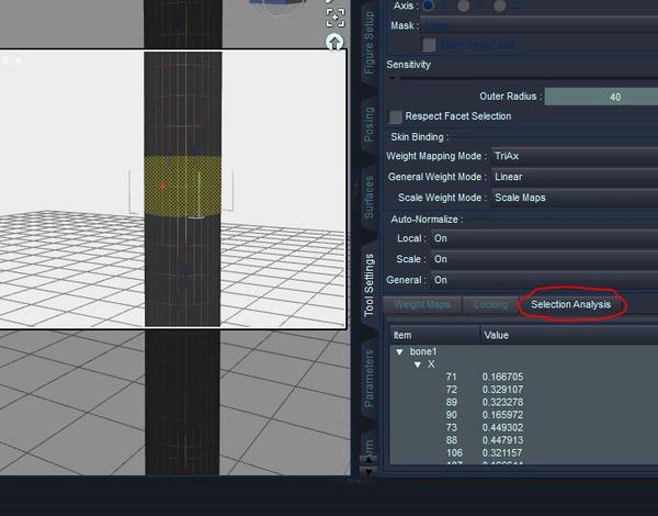

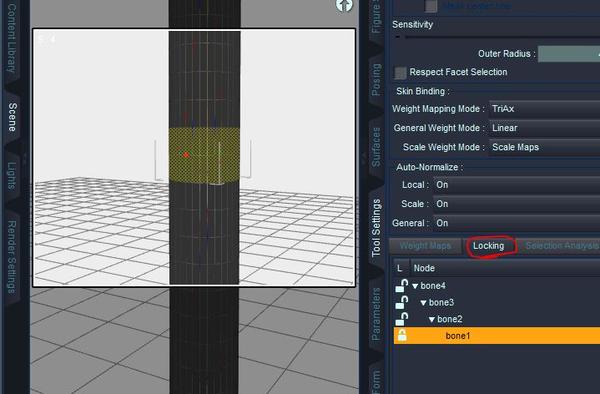

    if you want to protect mesh which colored weight map,
    select mesh by pogion group editor,,or using group selection, or with lasso, selection, ,,each mode waht you want.
    then change tool to weight map brush,,
    from tool tab menu>poligon rocking>Lock selected.
    it protect your mesh weight color changed.
    (you can not add any weight map for the mesh)
    then,, if you want to protect weight map which colored for each node,,
    in weight-map brush tool,, go under, Locking tab .
    then select the node which you want to keep the wieght maps and rock the node.
    in my test,, it can protect weight color for the node.
    if you colored weight for bone1 x rotaiton 0.7 or 0.8 about one vertices, then Lock the bone1,
    you can not fill color weight 1.0 for bone2 xrotation about same vertices which have already colored the weight by bone1 xroatiton.
    it seems keep the all weight value for bone1. (you can check weight value of each vertices which selected,,
    by selection Analasys tab)
