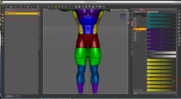

Thanks for the replies, I have these morphs on the figure;Michael Hero 1.0 and Fitness .90. I even removed all the morphs and kept the basic figure and still it show the poke thoughs. But here is a pic of it. Maybe you gents and Ladies can help me.
I think,, if you use basic suit in genesis super suit products?
if you use it,, you have not so many shape morph about the product,,

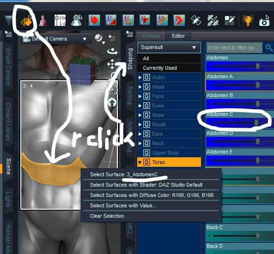

but if you used genesis super suit,, you can select the area by surface tool.
then right click you can easy find the poke through part name.
and you can apply shaping morph (thick)
then go to shaping tab,Torso>universal you may find many morphs wthich assigend the Abdomen area.
In my pic, now I select one area by surface selection tool, then right click to confirm the group name.
after that I adjust the thickness of the aera as I want.
it easy remove poke through. or bury under the skin more ^^;
