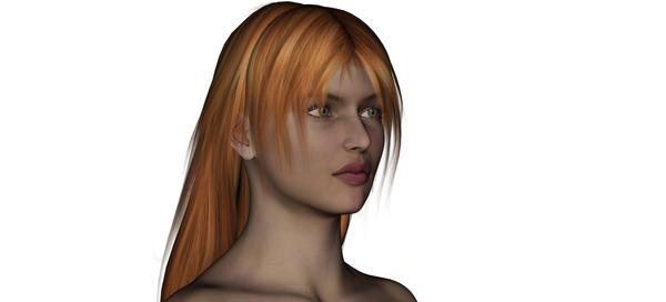

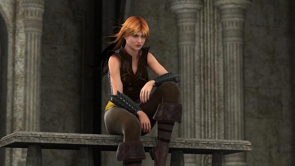

    this might help you out some. i am no good at advice, so please (Polar) bear with me.
    the first is a render i just did with no lights at all. it took me three seconds to render.
    the next is that exact same render, except i bathed it in wonderful environment lights, deep shadow maps, and a good camera FOV angle. it took 10 minutes to render.
    The last render, is that same second one, except i have put well made clothes on her, blew her hair up, then put her in an epic pose, and placed her in a huge beautiful cavern room, and added camera blur. and i also bumped the resolution up to Jesus levels. it took 40 minutes to render. click on this one to see its full resolution.
    do you get the Gist of the point, my friend? i could have added rain, fog, dust, monsters, and if i really wanted, i could have fully animated it and hired voice actors and such. and thus become famous. but that would have taken quite a awhile.

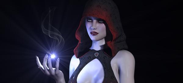

    also, here is an example of a render using only the uber enviroment light and one single spotlight behind her. it took me little effort to figure out a good shadow position, so i could put a shadow mapped light behind her. so basically this is uberEnviroment, and one spotlight. then i added the light ball and smoke using photoshop. does that help out?

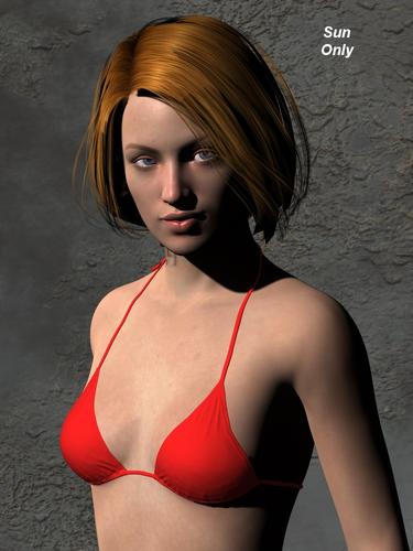

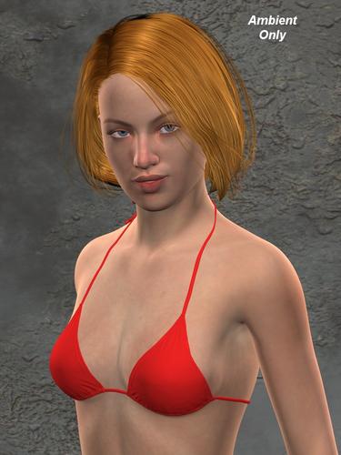

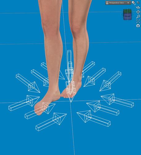

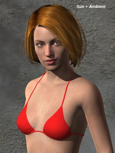

    Outdoors in the real world you not only have direct light from the sun, you also have refracted and reflected light coming from all directions. This is the so called "ambient light". In a biased rendering engine like 3Delight, you have to fake the ambient light somehow.
    Ambient light comes from all directions and does not cast a shadows, because it is coming from all directions. A very simple way to fake ambient light is to use distant lights coming from all directions with shadows turned off. For all directions I usually use 4 or 5 distant lights arranged as shown in the image. You can add more if you like.
    The image labeled "ambient only" shows a render with just this ambient light. This is what I call comic book lighting. It does not look realistic at all. Too much ambient light destroys the realism in a render.
    You need lights that cast shadows to make a image look realistic. If you turn off the ambient lights, and add a single distant light set to ray traced shadows you get the result in the image labeled "sun only". This image looks much more three dimensional and realistic, but the shadows are very harsh and don't look realistic.
    You need to combine the ambient light with the single shadow casting distant light you use for the sun. I usually use the sun distant light at 100% and the 4 ambient lights around 20%. This gives the results in the image labeled " sun + ambient".
    You could bring the ambient up more and the sun down, so the shadows are not as deep, but the more ambient light you put in the scene the more the lighting will tend towards the comic book look. You need ambient, but you need to keep it as low as possible.
    I have used this lighting in outdoor scenes. It is simple to setup and it renders quickly.

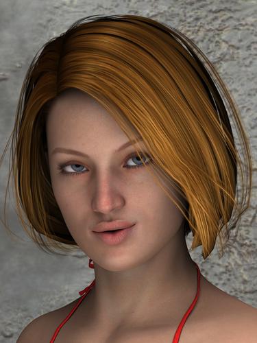

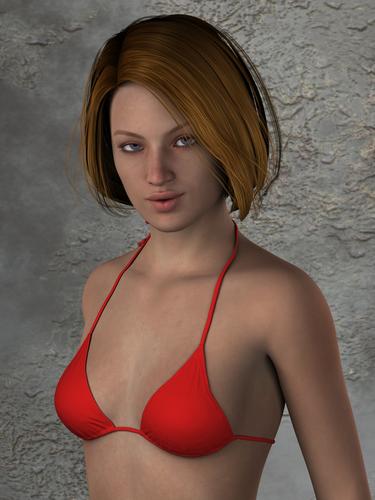

    The distant lights produce hard shadows that are realistic for a clear day outdoors, but are not that great for portraits.
    For portraits you are better off using large light sources that give soft shadows, like the UberAreaLight planes. The setup shot shows the basic 3 point lighting setup using UberAreaLight planes. I have parented cameras to the light planes for easier pointing. There is a tutorial thread on how to use UberAreaLight lights.
    The Main light is left of the camera and above. The fill light is right of the camera. The fill light is at 50% the intensity of the main light.
    The resulting image has shadows, but they are shallow, soft shadows. Those soft shadows are what gives the image its 3D look.

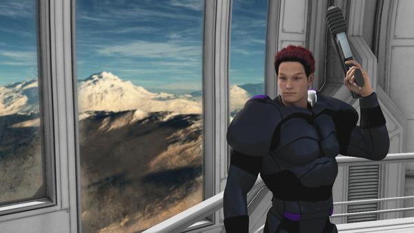

    One week on from when I posted this thread and just wanted again to express my thanks to everyone who replied with advice on how I could improve my renders. its been very much appreciated. I've been going through the above recommendations and trying my hand at Uberlighting which is a great tool. I also purchased the really cool Luxus training videos which have also explained a lot as well
    Here's a test using the Supersuit, GIS and a backdrop of one of my Vue images. I used one Uberlight and a directional light to mimic the sun and composited it all in Hitfilm. Still got a long way to go but all your advice has really helped this week. Thank you!
