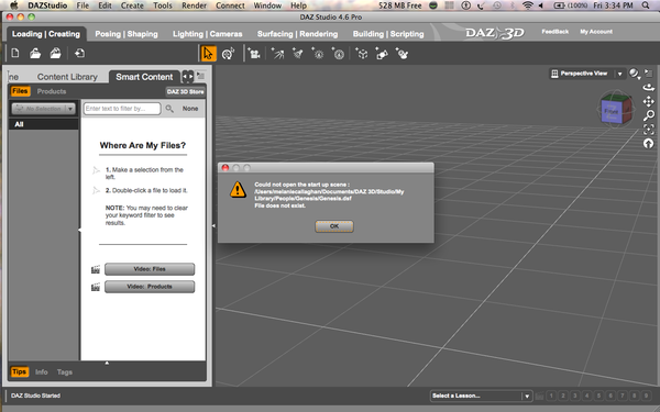

DAZ 4.6 is telling me I am missing genesis.dsf and FMbasicFemale.dsf after uninstalling 4.0 and installing 4.6.
I installed the Genesis 2 Starter Essential and Genesis 2 Female Essentaisl with DIM.
DAZ is looking for:
/data/DAZ 3D/Genesis/Base/Morphs/DAZ 3D/Base/FBMBasicFemale.dsf
/data/DAZ 3D/Genesis/Base/Genesis.dsf
DIM is telling me the files were installed to /data/DAZ 3D/Genesis2/...
However, under /data/DAZ 3D/ there is no Genesis2 folder. There is a people folder, under which what I think the Gensis figure is.
The files are .duf files and not .dsf. Are they what I am looking for? If so, how do I get DAZ to recognize them and the new directory?

    You need to install the Genesis Starter Essentials (the original Genesis) as well -- G2F Starter Essentials does not supplant them, it is an addition. You may also need to go to Edit > Preferences > Startup and change the startup scene to Genesis.duf if it still says Genesis.dsf

    Is it the startup scene that isn't working? Go to Edit > Preferences > Startup and change the startup scene to Genesis.duf
  • derchiegiancarloderchiegiancarlo Posts: 2
    AFTER I CHANGE on the Edit still show the same problem
    It's still trying to load the .dsf -- there should be a Genesis.duf in that some location.

    2 Usually Both of "start up scene" , and "new" load scene, are appointed to old genesis.dsf user scene files.
    about your case,, but genesis.duf file is actuall user scene files which DIM installed. and we should use it .
    if you can find genesis.duf not genesis.dsf in your contents library and Smart contents,
    go to preference >> select "Scene" and "Start up" As Mike said,,,
    then appoint new genesis.duf (not in data) about both (or you can select "none", I prefered this because,
