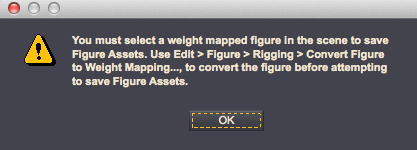

SO, I have Zbrush and I can send the garment there, modify it and GOZ it back again. But when I try to save it as any kind of asset, it complains about weight mapping, etc. I follow the suggestion of screen to convert the clothing to weight mapped but, surprise, surprise - the result is a mess.

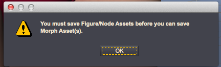

    Well, I made a morph using the DForm tool and tried to save that as a figure asset - it wouldn't let me save it as a morph asset. Here are the screen shots of both errors ...

    Right, you can't save a morph asset for a legacy figure. Sorry, I hadn't appreciated that it was the save stage that was throwing the error. Morphs should save with the scene, but I'd strongly advise exporting the morphed item, with everything else zeroed, as an OBJ as backup. If you save as a scene subset (File>Save as>Scene Subset) you will be able to merge into other scenes. You could also export as CR2.
