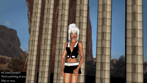

    recently i added a similar script but for the eyes
    https://sites.google.com/site/mcasualsdazscripts4/mcjstareatthecam
    https://www.youtube.com/watch?v=n7EDW5WxpT8
    480 x 270 - 1M

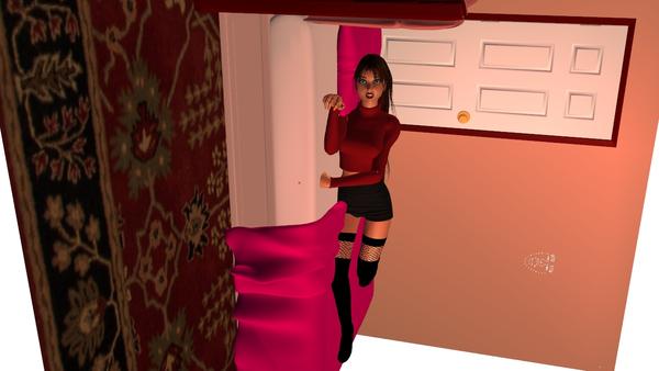

    Thaks¡¡¡ So I have a question. When the figure (i use g2f) is in bed, the head orientation doesnt works correctly. Please help
  • MilosGulanMilosGulan Posts: 1,989
    Wow, it looks great. I will have to try it :)
  • mCasualmCasual Posts: 4,607
    edited February 2015
    the script doesn't orient the head using a very complicated process
    it' works about okay for standing poses but for not for horizontal poses
    if you temporarily Z-Rotate the camera so that your figure, as seen from that camera looks like it's standing up
    then Look-At-The-Camera script will work
    once that's done, you un-rotate the camera
    or you could parent a camera to your render camera, we'll call it the laydown camera
    you z-rotate the lay-down camera until the figure as seen from the layDowncamera looks like it's standing up
    you make the lay-down camera the current viewcam
    and run the script
    1280 x 720 - 423K
    1280 x 720 - 356K
