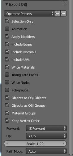

    I could do the tutorial but I'm too lazy ^^
    Basically you just need to export obj. from DS then import them with 'Keep vertex order' option. Then you assign a collision property to genesis or V4 and a cloth property to the cloth and run the simulation until satisfied.
    When happy, just export with 'keep vertex order. Then in DS you run morph loader pro with correct settings and you're done

  • Takeo.KenseiTakeo.Kensei Posts: 1,303
    edited July 2013
    Just checked to be sure, the options for wavefront import/export are on the left of the screen when in the file selection screen in blender
    I always had it there since blender > v 2.5 although the 'keep vertex order wasn't there in blender 2.53
    1078 x 1022 - 100K
    Post edited by Takeo.Kensei on

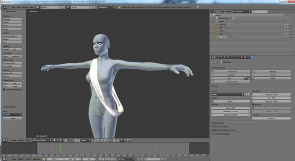

  • kitakoredazkitakoredaz Posts: 3,526
    Hi,, Takeo and Gedd,, any way thanks much,, to guide me next step.
    Now I am testing with some pattern by genesis and animedress,
    My workflow seems,, set two shape key, (zero poze , and after poze (which I need to render) of the Actor,
    then st key on timeline of two shape key.
    (the interporation seems terrible,, but do not mind it,,,, if more clean animation,,I may export more obj,
    but now I try with only two poze.. zero poze = zero frame kick poze = 100 frame.
    then test with cloth simulation
    (at first I needed to check with simple cube and cloth animation,, it work well @@; so that
    I step up to next step,, my puropse is not animation,, simply hope like phisics simulation in blender,
    then use the shape as morph,,,)
    Yes,,, it worked,, but may need more tweaking many,,, ^^,,
    Now trying,,,,
    643 x 537 - 44K
    710 x 469 - 45K
    it is Interesting,,, but At current for me,,,,, It seems not easy to modify as good morph ^^;
    (I can not say it is effective way to make morph with pozing genesis with usuall DAZ clothings,,now)
    but I hope to find good workflow,,)
    I want to use pin to fix some part of dress with genesis mesh,,
    but the pin seems fix vertices as universal positon,,
    dress type clothings loose off easy from gen,,,
    Anyway there are many option and cloth preset which I can tweak for simulation,,
    I may need to check one by one ,, each option value,, how work,,,
    I will try to import genesis obj more ,,with rotate rigs gradually,,
    then set more keys.

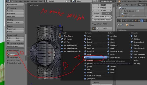

    Hi,, I want to ask about mirroer modifier,,, I think,, I understood the usage of the modifier,,,
    but Is it work when I make morphs for genesis or figures,, ^^;?
    because,, I read other solved topic,,, Vaskania said she used Mirroer modifier,,
    (it is solved topic,, so that I can not ask here ^^; )
    and my english is so bad to understand all of her working,,,
    but I am afraid Mirroer modifier may not work when make morph of genesis etc ^^;,,,
    when I use mirroer modifer,,
    Usually I cut the other side,, (eg left side meshes) then apply modifer, and tweak only right side mesh,
    after that join again.
    but I think it may break vertex order,, easy.. so that is their correct step to applly mirroer modifier,
    (not X mirroer on tool shelf )
    to keep original vertex order,and counts , then making morphs for figures (and props)?
    I believed,, I can only use X mirroer of Tool shelf (not modifier) when I make morphs,,
    but It can not work when I use proportional editing,,,
    So that I hope to know,, if there is right way to use Modifier mirroer when making moprh?
    blender with ds users help me please ^^;

  • Joe.CotterJoe.Cotter Posts: 3,362
    edited July 2013
    I believe Shape Keys will not reorder vertices and they can be mirrored as in the tutorial here. He kind of skimmed the mirror function without fully doing it and I haven't tested it myself though (part prior to Mirror X which he also mentions doesn't work.)
    [Edit] This video has a better explanation of mirroring Shape Keys.
    Post edited by Joe.Cotter on
    edited July 2013
    ><; Gedd,,,,thank you,,</p>
    yes,, I learned,,, shape key , and exchange mesh between shape key,, or mix shape
    do not change vertex order in blender,,, it is cool.
    then,,,,,,,,,,,, I asked about Mirroer modifier ^^; ,,,,,
    how do you think?? it can keep vertex order?
    and you can keep vertex counts when use mirroer modifier ?
    edted
    anyway thank you,, now i check again shape key with mirroer.
    Post edited by kitakoredaz on
    edited July 2013
    Shape Keys are only modifying the translation of the vertices, so as long as the mesh is properly imported/exported you should have no problem. They don't add/remove verts or change the vert order.
    oh great you tube tutoriall,, I though I already seen about shape key tutorialls,,
    but I understand,,, in shape key there is option to mirroer copy^^ thank you much,,,
    it is different from what I call mirroer modifier and the shape key mirroer ! ^^;
    yes,,, it seems usuful and I should use shape key mirroer option"
    not use mirroer modifier ^^;
    Shape Keys are effectively Blender's equivalent to Morphs in DAZ Studio, so it should be a good fit.
