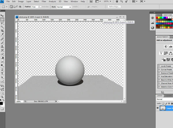

    As far as I can see, your HDRI would be the background image,. as well as supplying the light.
    You should be able to set the export to PNG and include the Alpha channel,. which should give you an image with a transparent background ,. then you can composite that over another image in a 2D editor

    3dage's suggestion of using the alpha channel is probably the way to go, but as another option, you can map your background image onto a plane and put this in the background at a distance, scaled to fill the frame as required. Just a possible alternative.
