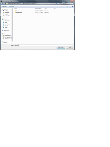

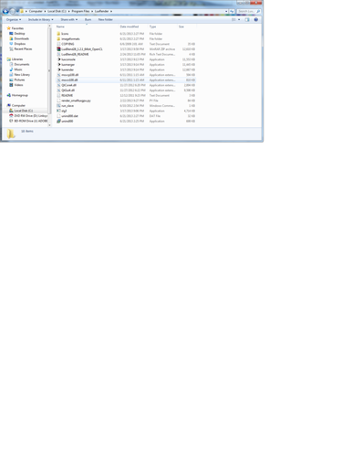

    Ok guys!! Iam lost here!! Sooo
    I downloaded Lux Render 1.2.1 on my PC
    I opened up Daz, went to my Reality Render settings
    Went to the Output Tab and I changed the path to where Lux Render was downloaded. (C:/Program Files?LuxRender)
    Down at the bottom it shows current version, o.9 ?????
    I tried to change the path at least 10 times, and its the same thing??? I have screen shots to show what I mean.
    If I go to C:/Program Files/LuxRender and open that folder there everything is!!!! as you can see.
    But, when I go into Daz 4.6 and go to Reality Render, then to Output tab, It shows the path but that 0.9 version??
    Heres what I dont get!!! From right there inside Daz on the Reality Render Output tab page and I go to change the path, the window opens up and I see the path C:/Program Files/LuxRender and if I double click on the LuxRender folder, there is NOTGHING!!! in the folder but 2 folders that have NOTGHING!! in them???? Its crazy!!! go out of Daz go to C:/Program Files/LuxRender folder and all that content is there???? PLEASE someone tell me what Iam doing wrong it makes no sence to me!! Thanks!!

  • SixDsSixDs Posts: 2,384
    Looking at your second screenshot (of the Luxrender folder contents), you seem to have downloaded and installed the version for Blender. On the Luxrender download page you will see several options to select the application that will be using the render engine. As said previously, you need to click the link for the standalone version. This is the one designed to work with plugins within your application (i.e. either Reality or Luxus in your case with DAZ Studio).
    You need to uninstall Luxrender, then re-download it as the standalone version and re-install.

  • StratDragonStratDragon Posts: 3,290
    edited August 2013
    I had the same thing happen, it does not impact rendering, if it is rendering in LuxRender it's using the latest version of LuxRender you have installed on your computer regardless of it saying it's using 0.9
    the fix was to upgrade Reality to 2.50 but you already appear to be running 2.50.
    Are you running 32 or 64 bit Reality?
