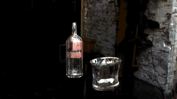

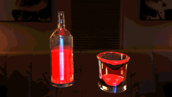

  • WendyLuvsCatzWendyLuvsCatz Posts: 41,806
    edited June 2013
    fancy a nice drop of red Rich?
    (all Carrara particles and morphs)
    800 x 450 - 5M
    800 x 450 - 2M
    unfortunately I used Daz props in that animation
    namely a bottle and glass from Souless empathy's bar
    I created a tip morph target on the fluid in the bottle and a fill/empty one on the glass fluid.
    I used the preset simple water nozzle with spread angle reduced to 1 & free in scene collide with everything but bottle
    (otherwise it trickled down the bottle)
    shaders were modifications of the digital painters glass and liquid ones, too red but wanted to show morphs in containers and filling, water one was more realistic with index of refraction for water addded.
