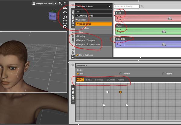

2) The puppeteer panel is a too small in Carrara . In DS it is detachable and can be resized to anything you want. This means you can create several "areas" of poses in the one pane. You can flip between these quite easily. The Daz video for Puppeteer demonstrates how/why you'd do this.

3) This is the BIG one LAYERS /TABS . I would equate them to NLA tracks in Carrara but very easy to use in DS. I have used it for facial expressions (Great for synching them with audio ) Thjats not the only thing of course and some interesting things can be done with objects.

Note - whilst doing this the parameters pane is visible whereas in Carrara you have to keep switching. (annoying)

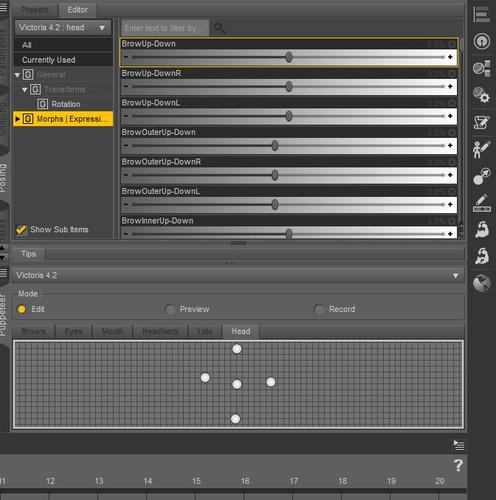

A couple of screen shots attached
