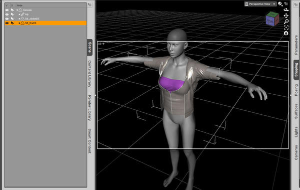

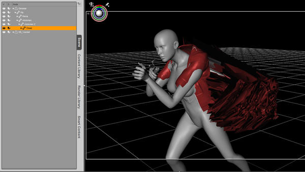

I am successful of fitting Hongyu's Sport Baby V4 clothes to Genesis but when I load the morph needed from one of the pose files weird things happen like the pictures below which a "duplicate" is left on the figure which when I check the scene tab, only one is listed. When the figure is posed, the clothes gets smashed.
I tried loading the clothes with the morph in DS3 then importing that to DS4.6 but once its fitted to Genesis, the morph disappears and the anomalies return when I try to reapply the morph.
Anyone could help?

    That's because V4's clothes are supposed to be used on V4. You can use the Autofit to get some things to work, but some things (shoes especially) will just not work. Skirts will almost always get stretched too...
    Generally, the best rule of thumb is to use clothing that is intended for the figure that it was made to work. Vendors can't guarantee they can be used on non supported figures... but with a bit of tweaking, you may get something to work out... good luck!

    If there are morphs that need to be injected, you need to do so BEFORE autofitting. After autofit the morphs are all there.
  • TheKDTheKD Posts: 2,711
    morphs need to be injected? I thought autofit made it so it follows all morphs automatically?
  • fixmypcmikefixmypcmike Posts: 19,741
    What morphs are you trying to apply from the Pose folder?
  • BejaymacBejaymac Posts: 2,014
    A little tip, when you convert a mesh from one figure to another, just delete the morphs as the changes to the vertice locations usually buggers the morphs.
