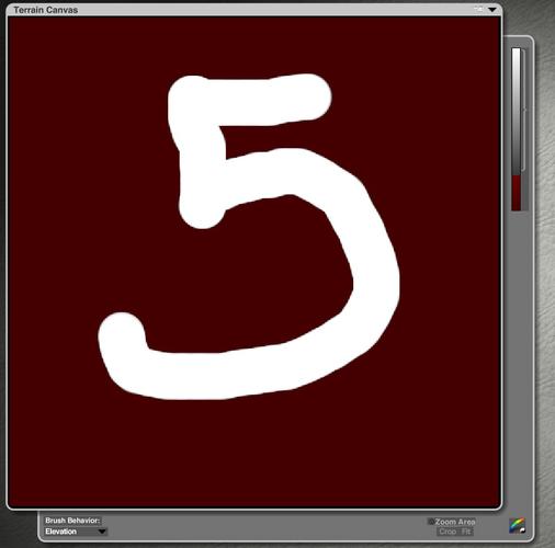

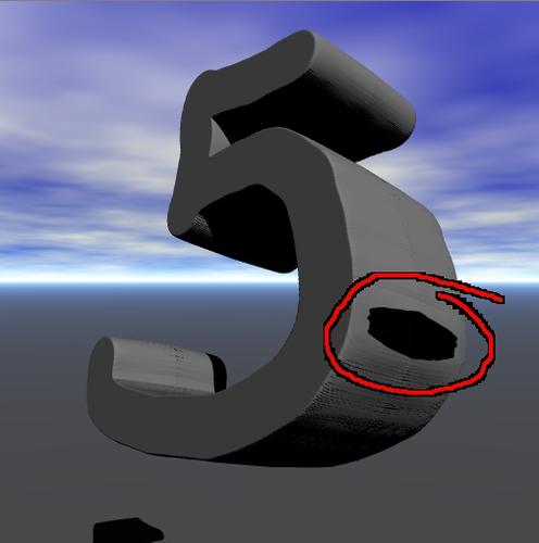

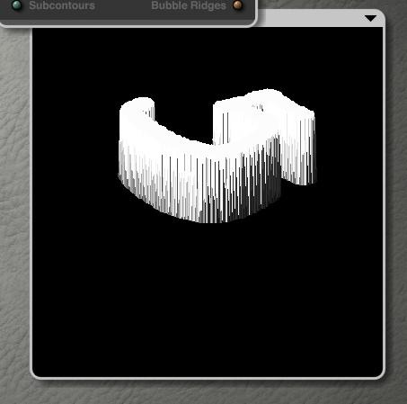

I recently installed Bryce 7 Pro on a Windows 7 machine (64-bit). Whenever I create a terrain/sym lat and use a black/white image to produce the shape, I get a hole in the side of the mesh on the right side. Tried adjusting various settings within the terrain editor (turning on/off solid, smoothing, clipping, etc.) but it would never get rid of the hole. Thought it was some glitch with the image I made in GIMP so I tried using Paint and got the same result. Using the brush within the terrain editor produces the same result. Changing the resolution of the mesh has no effect either. Anyone else have an issue like this?
Here's some screenshots (the preview window within the terrain editor doesn't show the hole). Thanks for your help.

    What I see is that the 'hole' looks like it corresponds to the exactly vertical edge of your figure 5 (as seen in the terrain editor pic).
    There is a glitch with Bryce where the underside of perfectly horizontal surfaces sometimes comes out solid black.
    The fix for that is to slightly tilt the horizontal surface, so maybe try tipping your figure back 1° so that the perfectly straight edge isn't vertical.
    Hope this helps.

    Yes I've run into this nasty bug before.
    4.30 in
    Bryce Landscaping - The importance of lighting 2b - by David Brinnen
    It's a bad bug and there's not a great deal that you can do about it if you need a very steep side to your lattice. To overcome the visible scene there is a temptation to try and make the sides infinitely steep but... these holes start to appear. Perhaps because it is no longer recognised as a face due to it orientation.
    One test to try, I'll try exporting a lattice with this problem and bringing it back in...
    OK see image, object on left, lattice with issues.
    Useing file > export object (about 200,000 poly here) (and as obj format)
    And then file > import object back in, and holes are fixed.
    Oh, don't export the materials, just transfer them over afterwards.

    No problem. If you want to quickly check if it is a hole (my bug) or a black face (Dave's bug) just pop a light source inside the mesh. If it is a hole you can see inside. If it is a black face, it will just stay black. Easy to diagnose.
