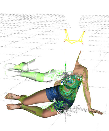

    THIS. THIS IS THE KIND OF PROBLEM THAT MAKES 4.6 UNBEARABLE.
    This has happened too many times to count!!

    Where can i find 4.5 to reinstall?? I'm really ready to give up on 4.6, its beyond buggy, its downright unusable. I have been getting about 5-10 crashes a day with 4.6 and i just can't function with that unstable a version of Daz. This is NUTS.

    If you didn't back up your installers I don't think you can. However, you certainly shouldn't be getting that many crashes so it may well be that there's a fixable issue that can be dealt with. The screen shots do look like some kind of display issue - what are your OpenGL settings under Edit>Preferences>Interface, and what video card do you have?

    Richard, I tried it with the two settings, and its not working. I'm still getting the same problem. I even reinstalled DS4.6, and GSE, and I'm still getting this issue. I seriously don't want to stop having to use Daz because its not working properly after all this :(
