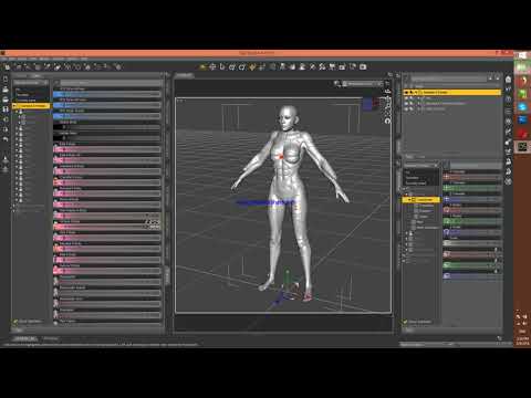

    So here is a small video on what I am doing. maybe someone can help me see something I am not seeing. :) I apriciate any help.
    Link removed
  • Richard HaseltineRichard Haseltine Posts: 111,306
    Link removed
    Well, first please make sure you are in Smooth Shaded preview if you are going to show a nude figure.
    Yo set the Victoria 8 slider, not Victoria 8 Body. Victoria 8 isn't actuall a morph, it's a controller that drives other morphs, so when you load your morph it gives the suit a shape that comes in for the Victoria 8 slider and but since there isn't a shape for Victoria 8 Body DS geenrates one to match the shape on the base figure and you get a dible effect. Rename your OBJ FBMVictoria8.obj, load that through Morph Load Pro, and you should be OK.

    Here is another video, in Smooth Shaded preview , showing me trying to fit some clothing to Victoria 8 and Alexandra 8 character morphs. The same thing happends, the body suit gets too big or too small on my characters, but only when autofitted. otherwise it is a perfect fit.
    I do apologise for asking for more help on this subject as it is driving me crazy not knowing why or how to get it to work properly. I have looked everywhere to find more information on how others fit clothing to Gen 8 character morphs and cant find any information on it. so I'm back to the forums.
