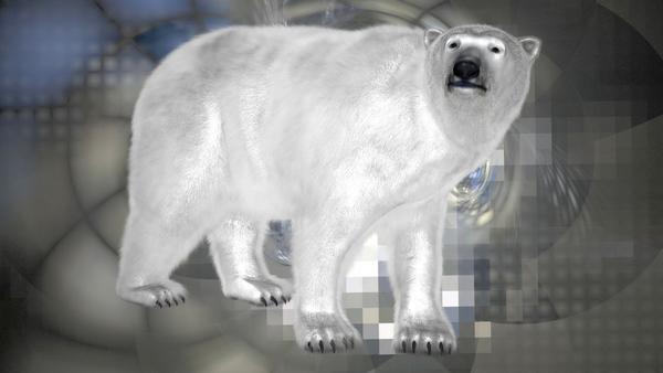

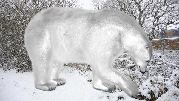

    I've attached a couple of renders
    Kindest wishes
    Keiron

  • StormlyghtStormlyght Posts: 666
    keiron said:
    Hi stormlyght
    Thank you for your help much appreciated
    Alessandro helped me get things working OK
    I had uninstalled LAMH and used the DAZ Download Manager to reinstall, but it installed version 1
    I added the mods and all is well
    Daz needs to ensure the download is updated
    Kindest wishes
    Keiron
    Hi Keiron,
    You're welcome. Glad you got it working!
    Thank you for sharing your renders. Love the polar bears, particularly your last render!
    Trish
