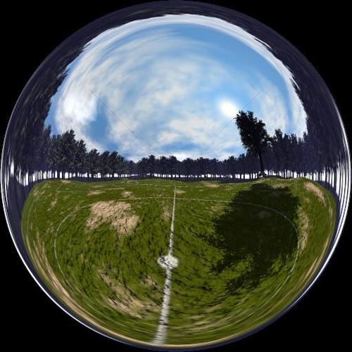

  • 3dcheapskate3dcheapskate Posts: 2,732
    edited July 2013
    How about down the park after skool? But cos we got less people than you bagsy we play downhill and have the giant levitating tree as our goalie!
    Yep, almost there with the instanced trees in Bryce 7.1 Pro... I know why the one tree's levitating and can avoid that next time. So the forest/jungle sets are one step closer.
    The local park's not exactly a sports stadium, but something along these lines (but better) might be useful for somebody? Pitch markings are easy (just an overlay for the terrain in Bryce) so cricket pitches, baseball diamonds, etc should be easy to do, and the method applies equally well to a stadium. Still haven't found any freebie stadium models, but I'm wondering about using a simple embankment and instanced billboards of people for a crowd???
    Edit: just found a couple of freebie sports stadium blends at http://www.blendswap.com/tag/stadium...

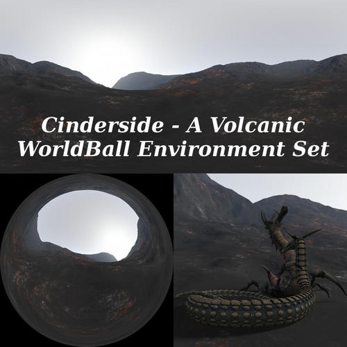

    And another, created in Terragen Classic...
    E16 Cinderside - A Volcanic WorldBall environment set
    Available from:
    - ShareCG - Cinderside Volcanic WorldBall Environment Set
    - Renderosity - Cinderside Volcanic WorldBall Environment Set
    This 360deg azimuth / +-90deg elevation environment set consists of:
    - A latitude/longitude mapped background image (4096x2048 JPG) - shown in promo, top
    - An angular mapped light probe image (1024x1024 JPG) - shown in promo, bottom left
    - A latitude/longitude mapped reflection image (1024x512 JPG) - not shown
    (bottom right is a DAZ Studio 3 render using just this WorldBall environment for lighting and background - full-size render in my Art Gallery thread)
    Intended primarily for use with the Simple Poser/DAZ Studio WorldBalls. See the Readme for the datablock to add to the WorldBallData.txt file.
    Also suitable for use with anything else that uses latitude/longitude or angular mapped environment images.
    (The Terragen Classic world and terrain files used to create the background set are included)
    Happy rendering!

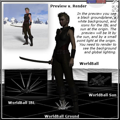

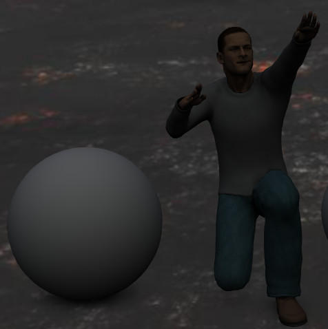

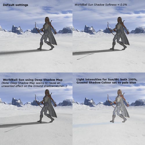

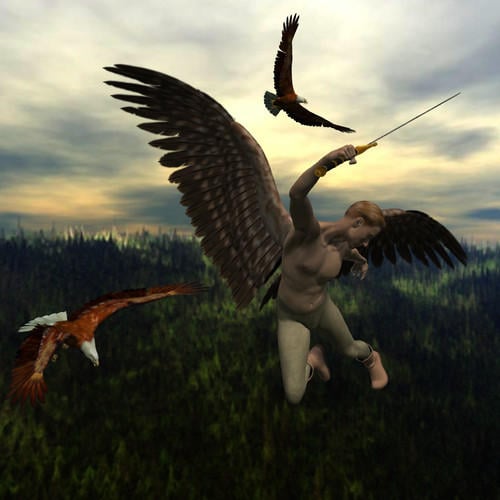

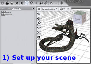

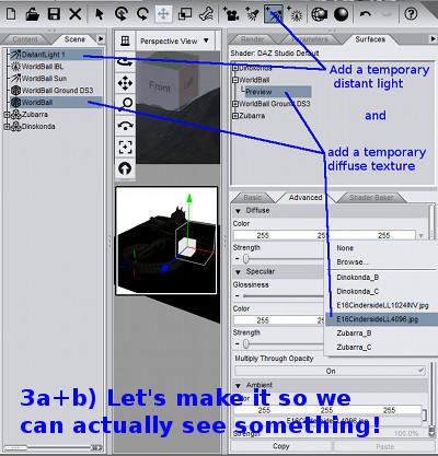

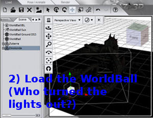

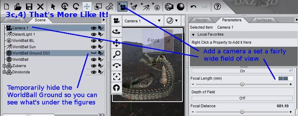

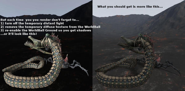

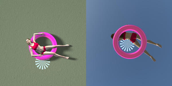

    A Couple More Hints - How I Use The WorldBall
    I'm no expert at photography, composition, lighting, or art. But I'm getting some fairly nice renders now, and this is how I go about it. Remember that my original goal with the WorldBall was to provide a quick and easy way to add a background to any scene - so I add the WorldBall almost as an afterthought!
    Here are the general steps I use. No real detail - you should be able to work that out for yourself. I'll be adding annotated screenshots using DAZ Studio 3 to help a bit. But note that the same steps apply equally if you're using Poser (except with Poser 6 I can't find a way to see the background in the preview window. Poser 8/9 seem okay)
    1) Set up a scene. I forget about lights at this stage, because I know the WorldBall should do that for me. I just concentrate on getting something that looks good from many different angles. This is what I spend the majority of time doing!
    2) Once I've got the scene completely set up I add the WorldBall, using whatever environment best suits the scene.
    - At this point everything goes very dark in the preview window (so dark that you can't really see anything).
    - Also you can't see the background.
    Those are the two major problems with the WorldBall!
    So I get round that as follows...
    3a) I add a temporary distant light - this lets me see things in the preview pane (N.B. this light must be turned OFF for any renders)
    3b) I apply the WorldBall environment map texture image to the WorldBall diffuse colour channel - this lets me see the background in the preview pane, except in Poser 6 (N.B. disconnectf rom the diffuse channel for any renders or the background will be much too dark)
    3c) I also temporararily disable the groundplane - this lets me see exactly what part of the background the figures will appear to be standing on (N.B. re-enable the ground for renders, otherwise you won't get the shadows)
    4) Now that you can see the background in your preview (except in Poser 6) you can set up the field-of-view, position, etc of your render camera. Adjust as necessary until to you get your final render!
    - If you want to rotate the WorldBall ensure that you parent the WorldBall Sun, IBL to it first! (the WorldBall Ground is up to you)
    - Alternatively you could parent everything in your scene to the WorldBall Ground, and simply rotate that.
    - IGNORE THE LIGHTING IN THE PREVIEW PANE! Remember it's mainly your temporary distant light.
    - Remember to UNDO steps 3a, 3b, and 3c before each render.
    - Remember to REDO steps 3a, 3b, and 3c if you want to make further adjustments
    (I find that the undo/redo cycle is fairly painless in DAZ Studio - more irritating in Poser)

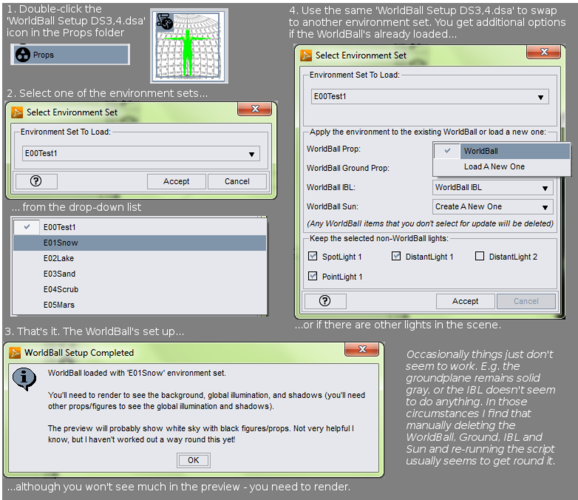

    edited August 2013
    Kyoto Kid: My guess is that you were looking for DUF files? You won't find any since the DAZ Studio version of the WorldBall uses a DAZ Script (DSA) file in conjunction with a Poser Prop (PP2). DAZ Studio 3 can't use DUFs, and this solution works for DAZ Studio 3 and DAZ Studio 4.5 (and I think there's been feedback that it works fine in DS4.6 too). You'll find the relevant file here...
    Your-DS-Content-Folder\Runtime\Libraries\Props\3DCheapskate\WorldBall\WorldBall Setup DS3,4.pp2
    ...and it'll have the icon shown in the first image below. But there'll be a little DAZ Script overlay icon in the top left corner (like the second attached image), indicating that when you click it'll run the associated DAZ script.
    Hopefully that'll get you up-and-running. If not, let me know!

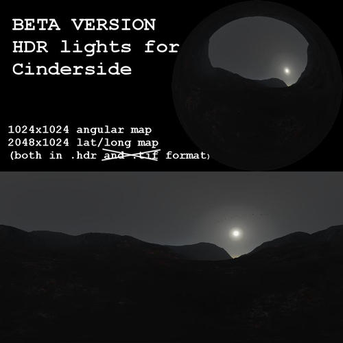

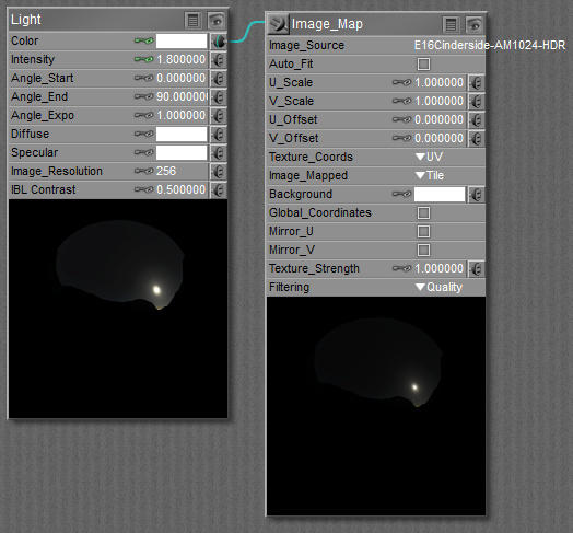

    I've created an HDR light for the Cinderside enviroment and uploaded it to ShareCG - Cinderside HDR Lights BETA. The upload contains two .hdr files - ones an angular map, the other's a lat/long map.
    If you haven't used HDR before I wouldn't recommend going anywhere near this one yet! But if you're familiar with HDR then please have a play - but you'll be beta-testing! Feedback very, very much appreciated!
    - The DAZ Studio WorldBall IBL wasn't set up to use HDR so it probably won't work - try using the UberEnvironment2? (Update: Works nicely with UE2 in DS4 - see post #91)
    - I think more recent Poser versions can accept an HDR image for a Diffuse IBL light? (Update: Tested - works fine as a Poser 8/9 Diffuse IBL. Doesn't work in Poser 6. Can't check with Poser 7)
    I've literally just finished creating it and started to play with it - so far just converting the .hdr file to a .tif in HDRShop v1 and plugging that into DAZ Studio 4's UberEnvironment2 (I'm not sure whether the the WorldBall IBL will take HDR images, so I want to start with something that I know should work!). I'm having some problems, but then I've never used UberEnvironment2 (although I just found this 'How to use UberEnvironment2 with your own HDR pictures ' RuntimeDNA thread and OmniFreaker's UberEnvironment2 wiki which help a lot)
    800 x 800 - 48K

    Using HDR Lighting With The Poser WorldBall
    I know absolutely nothing about actually using HDR lights in Poser or DAZ Studio, so I'm learning as I go. I found this 'Poser Pro Image Based Lighting' tutorial at SmithMicro.
    Since the WorldBall IBL for Poser is just a Poser Diffuse IBL I just tried plugging the E16Cinderside-AM1024-HDR.hdr (from the Cinderside HDR BETA I just uploaded) directly into the WorldBall IBL set IBL intensity to 180% and IBL contrast to 0.5 (as per the tutorial) and checked the AO box. Also turned the WorldBall Sun off (intensity to 0%) so only the IBL is lighting the scene.
    Poser 8/9 - it works! Looks a bit dark (P9 screenshot + renders attached), but I guess a bit of fiddling should fix that.
    Poser 6 - doesn't look like it can handle HDR IBL. It won't let me oped an .hdr file, and if I try to open an HDR .tif I get "Texture could not be loaded. Image map file could not be found, or there is not enough memory to load.")
    445 x 462 - 20K
    476 x 478 - 23K
    524 x 487 - 89K
