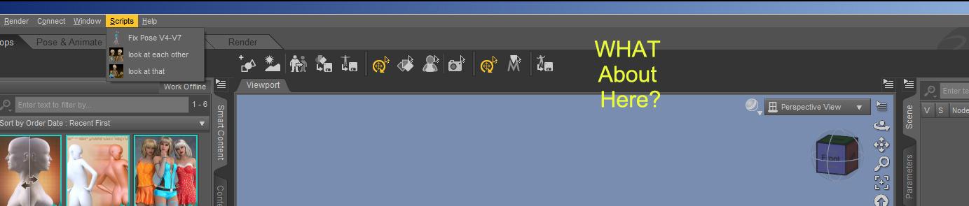

    Right-click on the script in a content pane and select Create Custom Action - that will create the Scripts top-level menu, if it doesn't already exist, and add the selected script to it. You can use Window>Workspace>Customise to add custom actions (from the top of the left hand column) to menus or tool bars (tabs on the right) by drag-and-drop.

    Drag from where to where?
    I have a custom action for LOOK AT ME where, under the scripts menu, there's a list of my favorite scripts....
    You mean where it is or the TOOL BAR area?
    1383 x 295 - 180K

    In Window>Workspace>Customise - the actions are in the list at the top of the elft-hand column, the menus and tools bars are in tab in the right-hand-column. Drag-and-drop between columns.
