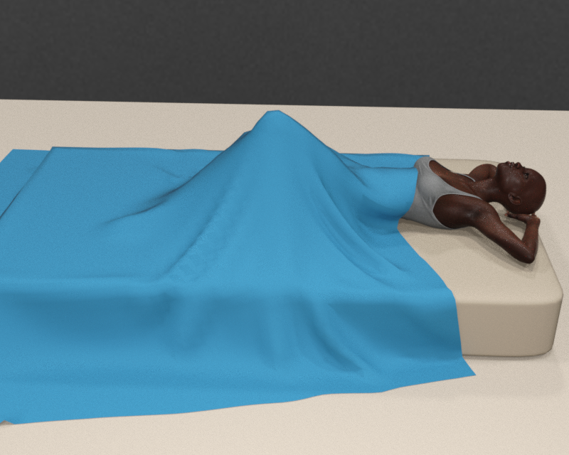

  • AnotherUserNameAnotherUserName Posts: 2,727
    edited March 2018
    And here are the results.
    800 x 640 - 573K
