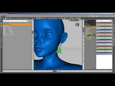

  • Ahhh Haaaaaa!!!!!! I figured it out!!!
    If anyone would like to know, here are the links to the videos. Hope they help. :)
    or search in youtube for Solid Rigging Earrings (extra bones)
