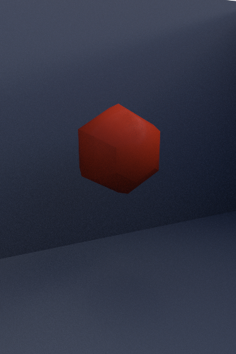

    Heres a test I ran with the camera Illdanstorm mentioned, https://heroineadventures.deviantart.com/art/Iray-interior-camera-for-DAZ3D-728244344
    This is inside a fully closed environment (4 walls, floor, ceiling) from https://www.daz3d.com/collective3d-create-a-room-base-set and an hdri set to infinate sphrere from https://www.daz3d.com/iradiance-studio-hdris-for-iray . Camera headlamp off. It turned out a little grainy but as you can see, the room is fully lit.

    If that is a fully enclosed space then the HDRI in the Dome isn't casting any inside light as it is outside the box.
    So im not getting light from the dome? I thought the camera allowed outside light into interiors. At least thats what I understood from the description. Curious. Maybe im using it wrong...
  • fastbike1fastbike1 Posts: 4,082
    The camera has Iray section planes associated with it. @AnotherUserName stated that an HDRI was used. If the section planes were not working, then the scene would be black.

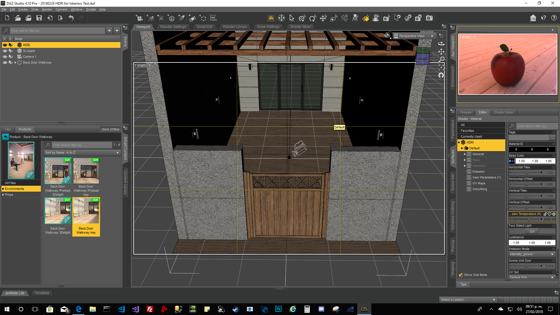

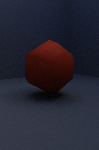

  • This is how it looks for me. I stopped it after 50 lterations. I think I also got no error message when I first tried it, it's just a normal camera with section planes.
    I created a grey cube, put these circles in there and set the render to dome only with the standard hdri.

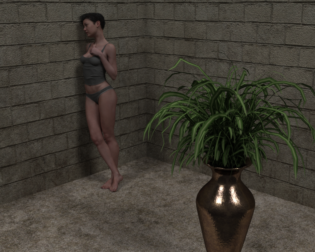

    Heres another example. Fully enclosed environment and only hdri lighting. You can even see the hdri lights reflection in the vase.

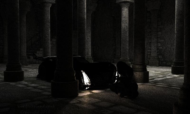

    I should have read the synopsis for the camera before I posted blush
    When I do an interior I tend to just use Emissive lights on any in the scene and for ambient I put the ceiling  texture in the Emissive channel and set level to suit.
    Like this one. There were only two walls and a floor so I copied and moved the walls to form a box. I can't remember if there was a ceiling or if I used a plane set to Emissive and there is a reading light set to Emissive over the desk.
    2017-08-22 08:52:43.012 Total Rendering Time: 13 hours 27 minutes 38.47 seconds

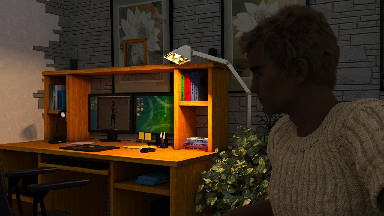

    This looks like one before I enclosed it so the Ambient light will be from the HDRI (I think laugh )
    2017-08-20 23:32:13.311 Total Rendering Time: 1 hours 52 minutes 56.90 seconds
