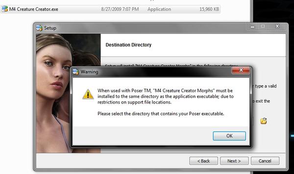

    Hey guys, sorry to wake this dusty thread up but a while ago I asked the very same question - why is the exe files not letting me install content for M4/V4 saying something about directories, blah blah... Same message. No one ever answered my question *sighs* I've googled this issue and only came up with 2 topics...and funny...neither were mine.. But yeah, I need some help! It happens now with every single character updating or adding exe. It even did it with Poser 8, PP2012 and now PP2014...
    Firstly, I've gone through every single possible post here on both threads I've found and followed the advice to no avail. Big fail! I even tried a few other ways. Nothing has worked.
    I use PP 2014 SR1, and my runtime is external so to keep my poor laptop happy (100+gigs of poser content!).
    Methods used:
    Recreate Daz Character folder destination in external hdd runtime (I've completely costumized my runtime) - FAIL
    -Attempted install choosing Daz Studio instead of Poser (ALL) to install - FAIL
    Recreated Runtime basic destination folders with a copy of V4 and M4 cr2 files on desktop - FAIL
    -added fake PoserPro.exe - FAIL
    Went to C:\Program Files\SmithMicro and added the necessary folders and cr2 files - FAIL
    I've received 2 different errors. 1, the directory error and 2, unable to find what it's looking for and will close when I hit Next/OK.
    So far all files I've tried not wanting at all to cooperate are:
    Hiro 4
    International Beauties M4 and V4
    M4 Muscle morphs (I can't recall the exact file name)
    M4 Creature Creature
    V4 Creature Creature
    Attached is a screencap of what I'm seeing... Ugh... Help!! *cries*
    765 x 453 - 125K

    That installer is pretty old -- the Poser issue with installing to the internal runtime was fixed in Poser 7 sr3. Pick DAZ Studio as the target program -- it will install the same files but not insist on finding poser.exe.
