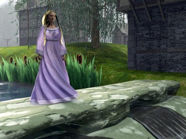

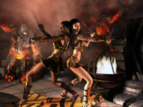

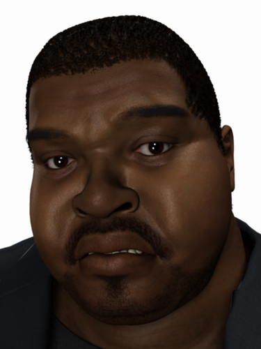

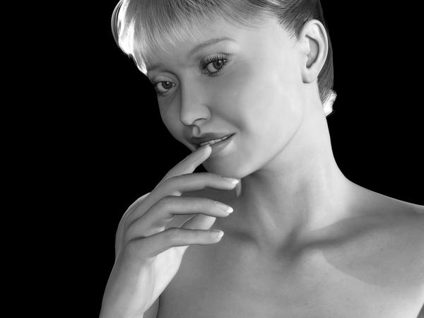

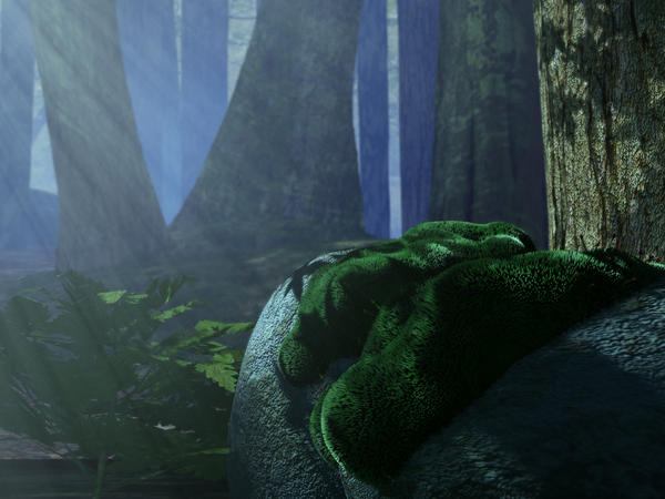

    Some examples of Carrara's hair (including using it to create moss and fuzz on cattails):
    2000 x 1500 - 2M
    2000 x 1500 - 985K
    2000 x 1500 - 541K
    2000 x 1500 - 890K
    2000 x 1500 - 831K

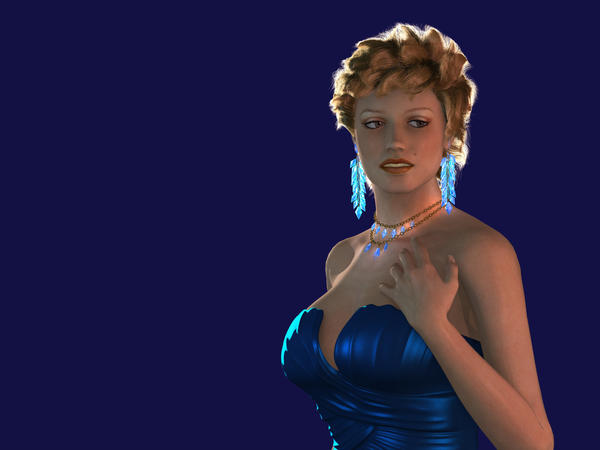

    Photo-realism isn't something I strive for very often. Here's a couple examples of the hair that are more photo-real than I normally go for. They're both the same image, but one I converted to black and white as that is what I was going for in the final image. It's been awhile for this image, so I don't recall what postwork I did. I think I may have added a light bloom, but that would be about it.
    The hair is a sample that came with Carrara's native content and is "grown" on a hair cap.
    2000 x 1500 - 552K
    2000 x 1500 - 868K
  • Kevin SandersonKevin Sanderson Posts: 1,643
