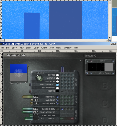

After a bit of playing around with a water material, I thought I found one that had some nice bubbles in it. However, it's not working the way I expect. It's like the bubbles only appear on the surface or something. Does anybody know what I'm doing wrong?
In the attached screenshot of a piece of the scene, the water material is a large cube occupying most of the scene (the camera should be inside it.) Then I have two other darker solid rectangular pillars also inside it. I can see nice bubbles in the background, but not a single bubble between the camera and the pillars.
The ambience channel isn't in the volume section. Does that mean it doesn't apply to the inside of the volume, only the outside?

    It's a tough one because you really need David's help on this as I think it may mean a tip into the Deep Texture Editor.
    It may be something as simple as that the 'bubble' texture is not in 3D space in the DTE.
    If you have the Pro Materials loaded, check David's Snow texture (I think it's in the Special Effects sub-folder).
    It maybe that you can edit that one or use it as a starting point as it creates white volumetric snow flakes within a 3D space.

    @TheSavage64, I located the "Integrated Volumetric Snow" in "Pro Materials" > SFX. That does give me bubbles between me and the pillars, although I will make some changes to the material as they are a little hard to see in this screenshot. It's a good starting point though.

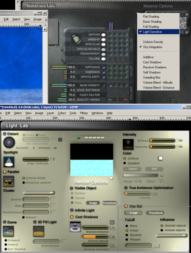

    Since I was going to be changing the material anyway, I got sidetracked into some of these tutorials and decided to try to add some light rays and water haze variations to my scene before jumping into the bubble idea. However, I can't seem to get the light rays to work. I have a light that's generating the caustic effect, I have a volumetric material with settings similar but not identical to the one in the example, but no luck. Other than having "light sensitive" checked, and being a volumetric material with visible variations in density, is there an additional setting that needs to be applied for this to work?
    screenshot includes materials, caustic light, and a partial render.
    The settings you have there look promising but... there is a lot to setting this effect up. What I would recommend is either, following the example I gave exactly in the video and than gradually adapt that or post me with what you've got and I'll try and figure out how to fix it. This is a very fiddly effect, very fiddly indeed, which is why you very rarely ever see anyone talking about using light sensitivity as a control.
