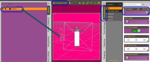

    here you go ...

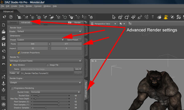

    Ok render sizing is set in the Advanced Render Settings Pane and shown in the image below.
