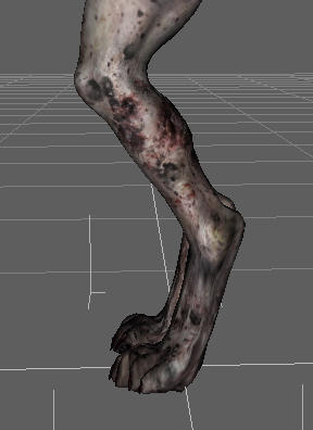

    5- That one's out of my league. lol The Anubis character has this, but from what it looks like the morph is tricked by using the heel of Genesis' foot as that extra bone, and then the front of the foot/toes are just morphed all the way down into the dog-like feet. You can see this in my shot below.

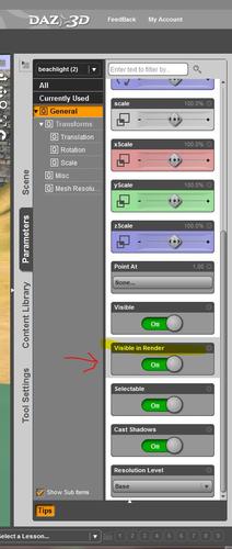

    For your lighting issue you should firstly save your lights as a preset if you want to use them again, File>Save As>Light Preset.
    Secondly you can go to the parameters tab and turn off individual lights or just set "Visible in Render" to off, see pic.
