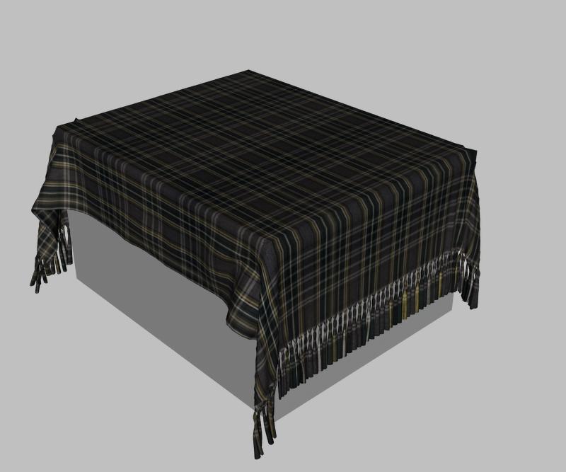

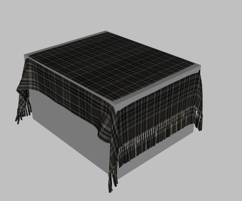

    @Rakuda thanks for posting the .obj file. I imported it, added a dForce modifier and ran a single frame animation with Start bones from memorized pose set to off. Simulation settings were default as were the surface settings. It draped fine but slow (even though I'm using GPU). The edges of the box show through but that can be handled post simulation by a small scale change. You can also add a smoothing modifier. I didn't play around with any surface setting which may avoid the need for scaling.
    Here's what I got:
    After simulation:
    After scaling to 102.5%:
    After simulation and adding smoothing modifier:
    After scaling to 104%:
    Not sure why it's behaving differently for you. If you haven't, perhaps shut down DS, reopen, import the rug again, and add fresh dForce modifier (no weight map).

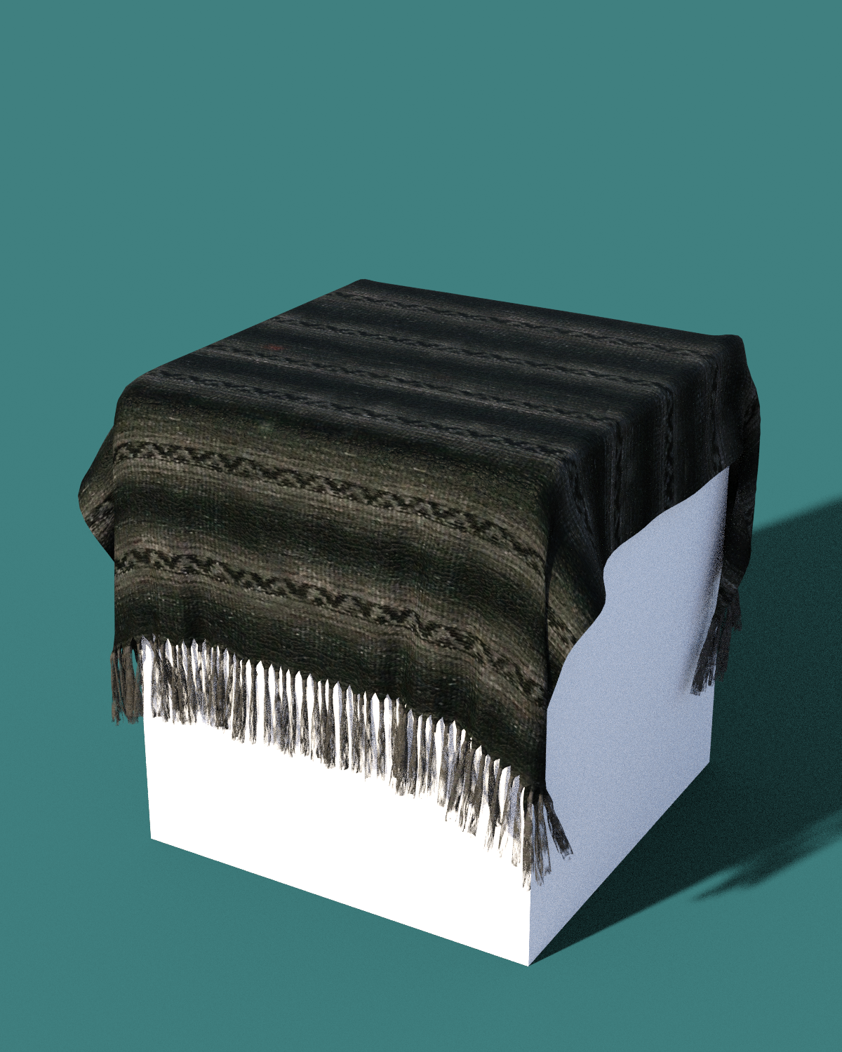

    @Rakuda, your rug imports to Daz Studio and simulates fine for me, too. I let it drape on a primitive sphere. I scaled the rug up by 500% to fit my 1 meter sphere. I applied Carpet Measured material from the Default Resources product. I added dForce Dynamic Surface to the rug and used the default simulation settings. I'll attach the render and the scene for you to examine. I got the messages about the "springs", too. It happens even with dForce items sold in the store. I don't think that is the cause of your problem, but I don't know what is. How did you import the obj to Daz Studio? I'll attach a screen shot of the settings I used to import your rug obj.

    @Rakuda, I wonder now, whether your problem is caused by importing the rug at a small scale. As I mentioned, I scaled it up by 500%. If it is too small, it will trigger more of those spring errors messages, because the mesh for the fringe is so close together (closer than the default collision distance).
    Edit: Well, I tried simulating it at a small scale, and I got a bazillion spring messages. Then it disappeared completely when the simulation started. I suggest making it larger and then simulating. Make it rug-size.

  • RakudaRakuda Posts: 938
    edited February 2018
    @barbult you may have been right about the scale. I was able to use your file successfully. And modify it to re-simulate.
    That did solve it to some degree, but I do notice that if I appply the dForce presets in the "dForce Master - Cloth Simulation Presets" set such as the weight of jeans fabric, the simulation no longer completes. I need to investigate what changes beyond it switching the bones to memorized pose "ON".
