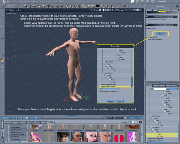

  • 3DAGE3DAGE Posts: 3,315
    Hi Storyteller
    You can add a Target helper object,.. or you can use IK helpers,..
    You can find information on their use in the Carrara manual.
    But before you do that,.. can I ask you to look at the Key-frame Tweener types (the sections between key frames on the sequencer timeline.
    It may be that the tweener type is set to bezier or linear,. which is allowing the foot to move,.
    You can change the type of motion tweener,. for example: the "Discreet" tweener,. will "hold" one keyframe value,. until it reaches the next keyframe.
    you can also add more key-frames to that section of animation, to control how that object behaves.
    There may be easier ways to solve your animation problems before you get tied up in IK chains.
    You can actually load in a David 3 figure,. and have Carrara create the IK helpers automatically for you.
    If you use File / Import,. instead of loading the figure from the browser, then you'll be presented with some import options,, which includes the option to "Add IK targets"
    This creates IK target helpers,. but doesn't enable them. ..you can enable IK tracking from the Top right hand menu, Modifiers tab.
    If you already have a Scene with a David 3 Figure,.. loaded and animated
    then you can add target Helpers,. to that figure, and enable the IK tracking for that figure (see pic).
    If you've not used IK before,. I'd suggest creating an new scene and experimenting with it to get a feel for how it works and what you can and can't do while using iK targets.
    Hope it helps :)
