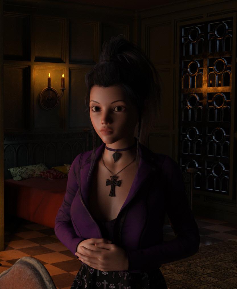

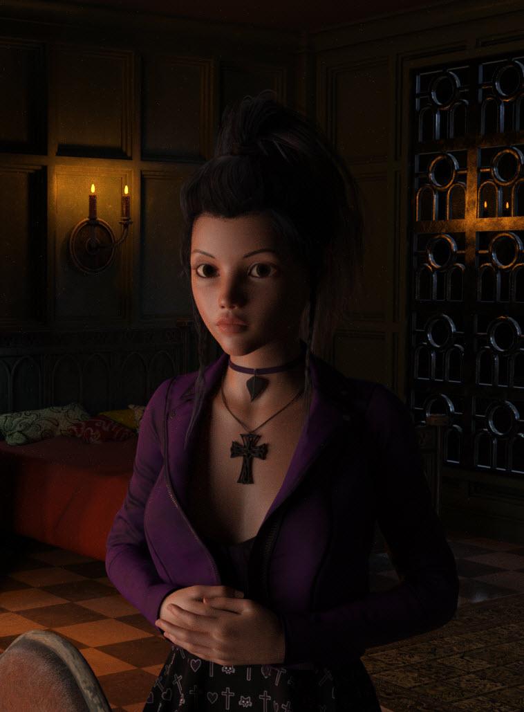

I'm pretty frustrated here.  I played around with filtering, and I still can't get sharp focus.  I just don't know what I'm doing - right or wrong.
Three renders, all are done with Pixel filter set to Mitchell and Pixel Radius at 0.5, 3000x3750 full body view.  When I look at the face, it is either not sharp or pixelated.
First render is done with Boss Pro Lights
This is with Ultra Genesis (box lights)
This is with Aurora Lights (photometric spotlights)

  • LinwellyLinwelly Posts: 6,070
    did you max out render time and iterations? You image is on the dark side, those take longer to get cleared up in Iray, so the alternative is to brighten up your image.
  • OdaaOdaa Posts: 1,548
    Or render it out at 2-3 times the size you need and scale down, although that technique hasn't worked that well for me.
  • L'AdairL'Adair Posts: 9,479
    As @Linwelly says, dark images take longer to clean up. Think back to film photography. The lower the ISO the finer the grain of the film, but the longer it needs to be exposed. ISO 400 was really popular for snapshots, but enlarging the image frequently showed a lot of grain in the darker areas. When I was still using film, most of my film was ISO 100, and some of it was even ISO 50! (Most of my photography was outdoors.) Even now with my digital camera, I keep the ISO to 100 most of time, (though my XTi is quite old, by DSLR standards.)
    You can make the image brighter in the viewport, then use Tone Mapping to render it darker. Or render it brighter and darken it in Photoshop, Gimp, or whatever software you use. Or if you prefer, you can set Daz Studio to render the image longer.
    To force Iray to render longer, start by turning Quality to Off. Now set Max Time to 0 (zero), effectively turning off the timer so the render will continue until it reaches the value in Max Samples. This is how I always render now, unless I double-click on a render setting and don't notice it's changed my default setup! (Annoying!) Anyway, I usually control quality of my renders by setting Max Samples. (Max Samples has a limit of 15000, which can be changed in the parameters. I've turned Limits off on that setting.)
    If my render completes and I don't think it's done, I just bump up the Max Samples and Resume the render. No need to start over.

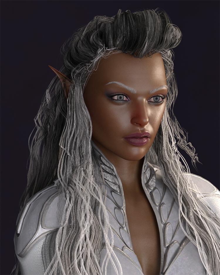

    I tried Tenebroso Lights, using the soft gray TL Soft 5, and moved the prop away to tone down the light.  So yes, I added more light and a different kind of light.  There is some very subtle pixelation in the shadow of the cheek on the left side (her right cheek).  I could try the increase render time trick... but maybe I'm being too picky.
    My only complaint is that the light is so soft that there are no highlights in her eyes.  Guess I'll paint those in Photoshop.
    You really can't see it here because I had to size it down for the forum.

  • kyoto kidkyoto kid Posts: 42,499
    edited February 2018
    ..I'm wondering if it isn't partly due to the skin bump.  Could you post the non downsized image?

    The original is over 2 MB.  The closest I can get is 94% and still be able to post it.
    940 x 1175 - 2M

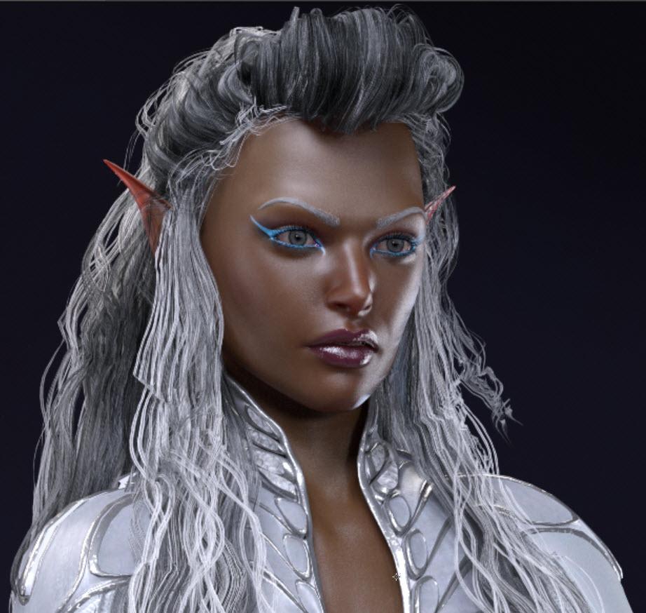

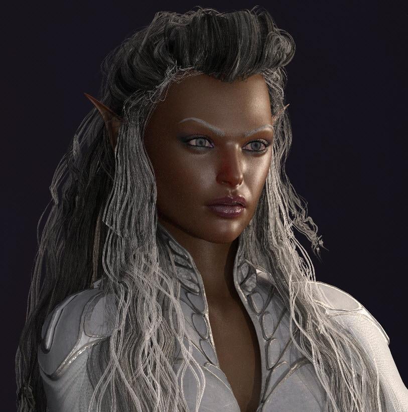

    It seems that it's not so much that a render is dark that causes fireflies, it's more the character of the surface. Here are some crops from a render that has run for 9 respectively 20 minutes (GTX 1070), the dark areas are generally fine but her skin is still affected, after 20 minutes.
    758 x 1029 - 101K
    833 x 1015 - 95K
    Post edited by Taoz on
  • TaozTaoz Posts: 10,384
    Hm, the forum is recompressing the pictures so details are lost, so here's the originals:
    http://taosoft.dk/temp/iray_dark_render1&2.jpg
    ...indeed that looks to me more like surface detail than pixelation otherwise the edges would be more "ragged" and there would be fireflies in the black background.

  • dracorndracorn Posts: 2,384
    Great, thanks.  I'm happy that I finally have a clean image.
