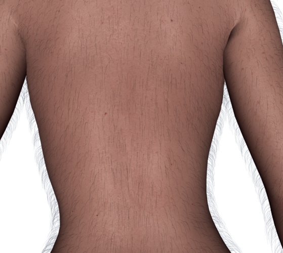

Hello all! I just got this wonderful plug-in. And I can see the possibilities with it, yet, I think I missed something. On first playing around with the program, I thought I'd do a simple short haired furry coat over one of my girls. (Mostly just the torso skin selected) In the LAMH preview even with the density pumped up to 100%, it still shows up as plain ol body hair in the render (And creepy body hair at that). Perhaps I missed something and somebody could perhaps enlighten me? I have tried a few of the presets and they seem to work as desired. The hair is lush, thick and covering.
1010 x 904 - 1M

When exporting the hair from LAMH (that's the window with RiCurve or OBJ drop down menu) make sure you type a sufficiently high number, I'd say at least 500 000, perhaps more, and make sure to press the Enter key. 100% density is only for the OpenGL preview, not the hair themselves.
Ah, thank you for explaining that to me. I played around with it and 500k seemed to of done better. I'll post a new picture soon. But even after watching the tutorials, I still don't quiet understand how to make it look like a fur coat. Should I play around with the root/tip thickness?
Yes Root more than tip, they both play in getting thickness like the Total hair count does.
