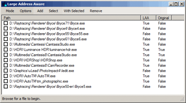

I've been using the Large Address Aware app to tell Bryce to use more memory and it seems to work
as Bryce does'nt crash so often.
I would like to know if I need to run it every time I run Bryce or does it change Bryce so it knows every time.
If I need to run it every time is there a way to have it running at PC startup?
Thanks.
  • HoroHoro Posts: 11,740
    No, no need. This is a flag that is set and it stays set until you reset it - which can also be done if you got it from http://www.techpowerup.com/forums/showthread.php?t=112556. If you use the Expert mode, you see which programs are set to LAA. The picture shows my present settings.
    602 x 332 - 17K
  • StuartBStuartB Posts: 600
    Thanks Horo.
    Does that mean if I set it and exit the program it stays set, and after a reboot of the PC it stays set.
    Exactly. It will stay set (or unset) until you manually change it. Booting doesn't make any difference. If you re-install Bryce, that's another matter.
