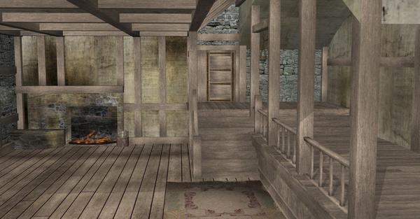

I have a building interior that I set up to use in Bryce. Should I leave it grouped the way the model imports or ungroup it. This is the first interior I've tried in Bryce so not sure what to do after parenting all the beams etc to the wall sections.
I hope the image attaches OK..

  • Dave SavageDave Savage Posts: 2,433
    That's a nice looking interior.
    What some people say is that grouping only makes Bryce draw more boxes and everything that Bryce has to do extra takes up precious memory.
    What I usually do with complex models is select pieces and organise them into families using the families block in the object's little floating sub menu (second icon down usually a solid grey square icon). Families are neat because if you have all your wood as one family, you can easily select that family to change all the wood at the same time. Same goes for all the stone or any other set of objects that share the same material.
    If your model isn't slowing Bryce down or causing memory problems, you can also group the whole thing as one group so you can select it all easily to move, rotate or resize it. Just one group isn't going to labour Bryce too much.

    @ravynclover - use grouping only for boolean operations. Use families and parenting otherwise. And that interior does look nice!
    Great looking interior! Very impressed that this is your first. Those above have answered your question, I'm going to make a comment about lighting. Lighting interiors is very tricky. Very tricky indeed.
    Do check your shadow intensity settings, looks to me like you might have a bit of a light leak.

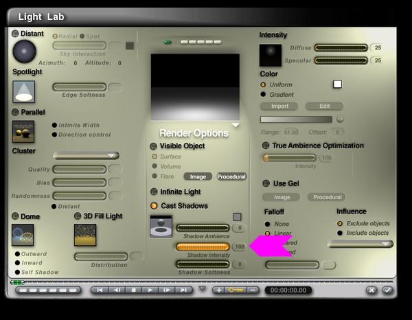

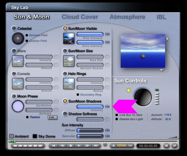

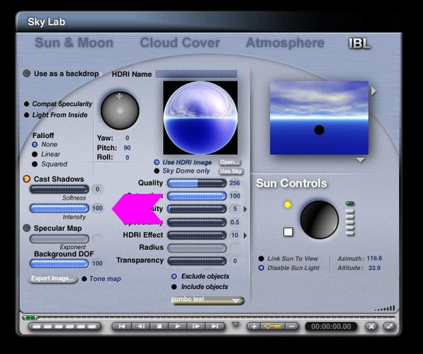

    I've marked the shadow intensity controls - ideally these should be set at 100.
    Skydome colour - particularly for an interior should be set to fully black.
    And unless you want a special effect, set the Global Ambient colour also to fully black.
    Those last two swatches are shown in the very left hand corner of image 1.

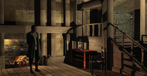

    Did a quick, close up night time scene for my desktop. Not the greatest but it gives you a better look at the fireplace. Lights are the hardest thing for me to get right in any program, tho I don't find Bryce as confusing as some of them..
    1500 x 783 - 852K
  • HoroHoro Posts: 11,742
    @ravynclover - looking good. We may argue whether the black shadow parts are not too dark, but if you used a fast film for your photograph, that's what it would look like. What we cannot argue is the dark back of the gentleman. There's a fire and that should light up the back slightly. Nevertheless, small quibbles. Very nice render. The model is just great.

    Don't know why but I'm a big fan of the dark, hard shadows. I was so busy trying to get some light on the figures face that I forgot about the back. Should have pulled the fireplace light a little further forward. I have got to learn to do those god rays. I'd love to do images with the light streaming thru clouds or windows. So far nothing I've tried looks anything at all like the tuts I was using.
